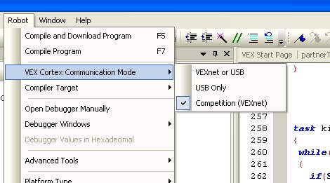

OK, so a couple of things.
The most important is to make sure you download the code for competition and then power cycle the cortex (only once is needed then it will be in competition mode). There is a bug in RobotC that causes the autonomous flag to toggle if the cortex is not in competition mode.
https://vexforum.com/attachment.php?attachmentid=5218&stc=1&d=1328473540
If you do not do this I see the effect you describe. This was not an issue in RobotC V2.32 last year, I had seen this before and think I had done a bug report but need to remind them. It may also be a master firmware issue rather than a RobotC issue. Anyway, get the cortex in competition mode and you should be ok.

bStopTasksBetweenModes is an initialized global variable so this is not necessary. I downloaded and ran masterglitch96’s code yesterday so he should be OK if he follows my instructions, although, having said that this line of code
#pragma competitionControl(Competition)
will force RobotC to automatically select competition download for you so it may be something else entirely, perhaps a bad connection to the competition switch or something like that.
