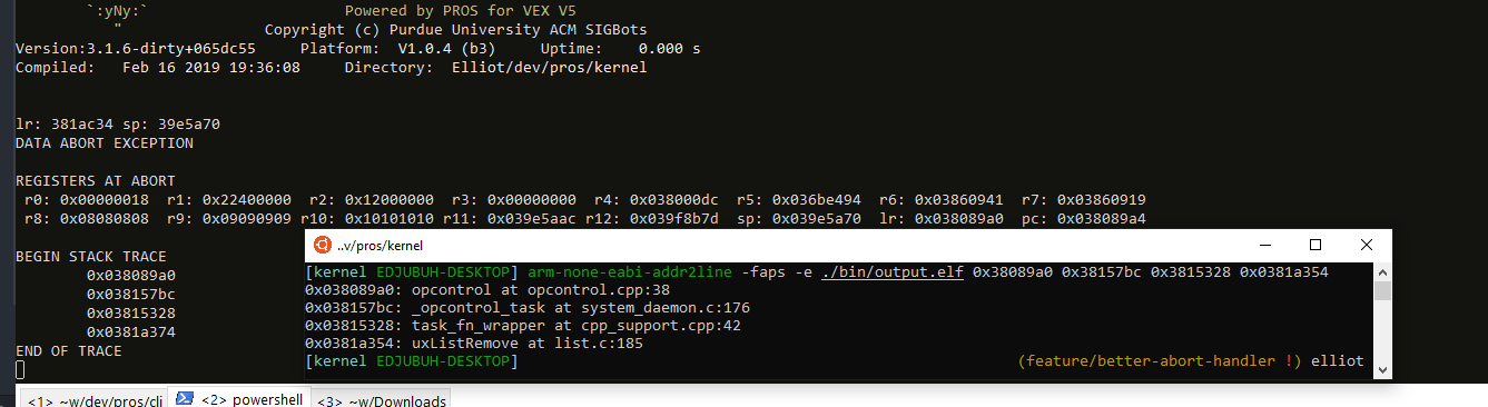

ps. If you were to do this project in pros, they have a feature that when the program crashes it outputs the current stack addresses, which you can use to find the exact line that made it crash.
