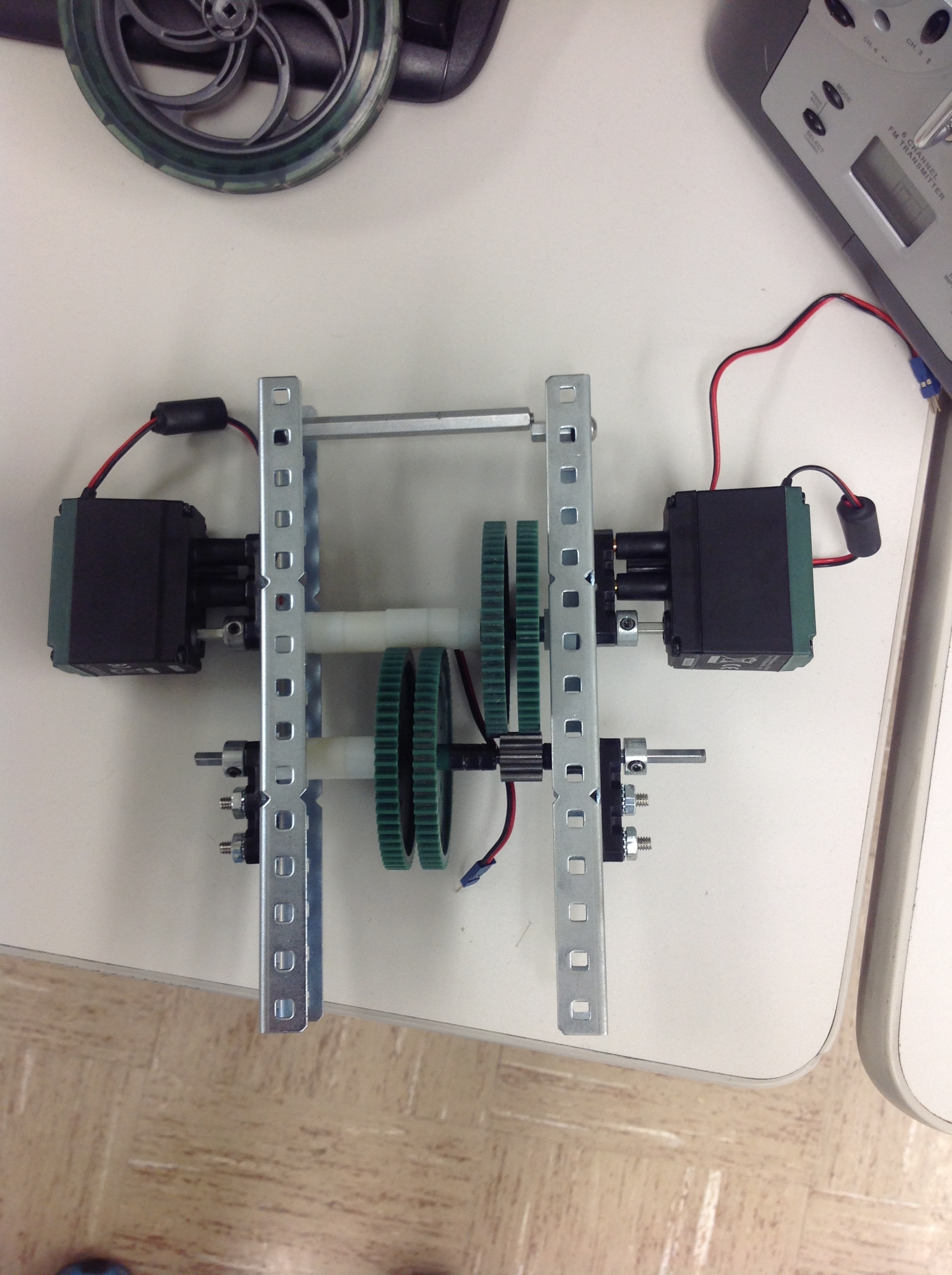

I dont really know where to start on my flywheel. Thats the problem, lmao
Start by settling what overall design you want. (single flywheel, double flywheel, how many wheels, etc.) Then decide what gear ratio you want to run. Past that, gather the materials you need to actually build it, like bearing flats, screws, nuts, motors, spacers, gears, etc. From there I typically mount the bearing flats and motors in the appropriate places, and then attach shafts, spacing, and gears.
How do people use two motors to power one set of gears? I don’t know if you know what I mean but I dont know how else to word it. Like when people have a 4 motor flywheel, they have two motors on each side. What does the second motor do?
The second motor adds torque(strength) to the system. This makes it easier for the motors to spin the gears with all that pressure. With flywheels, having 2 motors usually gives you more speed because usually, one motor does not have the torque to spin the system. That extra torque gives it enough power to spin at max power.
Oohhhh
So you would have the first motor on the driving gear and then the second motor on the next axle up?
No, you want the motors to have the same ratio. Either gear the motors together with the same gear, or put them on the same axle.
I thought about that but wouldn’t they be outnof sync?
We have two motors on the same axle, and they work fine. They start slightly out of sync, but you can just turn the axle to get them in sync.
@brennahravan
One on each end of the axle?
Here is a photo of a robot that my students built. It uses four motors linked by 36 tooth gears with a single axle, highlighted in yellow, that drives the gears up to the flywheel. This should give you some reference.
This is a little off topic but why is that axle gold? And why do you use a single flat plate stead a 5 wide c Chanel ?
It’s merely a highlighter on the photo and not gold in real life. :slight_smile:
There are numerous axles in the photo that are on the same planes - meaning that two axles are end to end at the same hole with bearings on both sides. It looks like one axle but they are two separate and it’s hard to tell in the photo. The only axle that goes through is the one that I highlighted with a photo editor.
The flat panel acts as a sub-assembly that can be pulled by removing four screws and loosening a shaft collar in less than 30 seconds. It’s set up this way to test (and replace) the motors individually or test the flywheel for friction without the motors. The team even had a spare set ready to go. To answer your question, the gears in this design extended past the edge of the panel and the c-channel edges got in the way.
Would something like that work?
