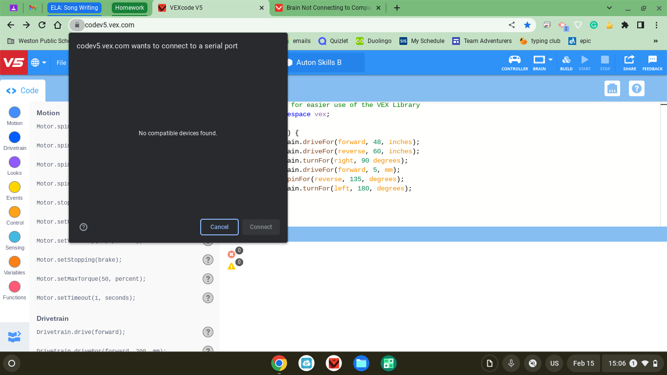

Hi! My brain isn’t connecting to my computer…
Some cords do not support data transfer, please try a new cord. If that doesn’t work, it could either be your device, or the brain.
3 options: try a different cord (needs this data logo shown below on it), try a different port on the computer, or try a different computer and/or brain. How can I tell charge-only USB cables from USB data cables? - Electrical  Engineering Stack Exchange
