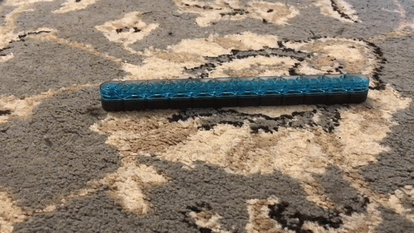

@242EProgrammer I believe N33334Z is trying to say that the catapult keeps breaking off of the robot chassis like this (minus my hands)
And then why is the catapult connected to the chassis? If you mean the base of the catapult, use more pegs, use capped pegs, and we need pictures or lots of description.
Yeah that’s kinda what’s happening with it. Except almost every peg slot is filled and there’s really no more room. We’ll see what we can do though!
Also honestly I don’t know what it’s connected to. It’s in a weird middle part between the 4-bar and the chassis.
Ok, I kinda know what you need to do, but it’s hard to explain. The best I can do is say, don’t have the catapult attached in such a way that when you pull up on the catapult, it pulls apart the pegs that are attaching the catapult base to the chassis. Have it something like so when you pull up on the catapult it would be like pulling the blue bar in the video above to the right and the gray one to the left. You see how the pegs would not come out that way?
