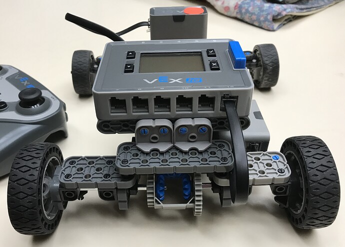

I have created a fairly simple four wheel bot. It uses one motor to turn the front wheels. The design uses gears and connecting rods to turn the wheels. The motor is geared down by a factor of 3 to turn the wheels.
I also use a differential to drive the rear wheels. The drive motor is geared up by a factor of 4.5, so the bot moves fairly quickly.
Here is a photo of the turning gearing:
Here is the rear wheel differential:

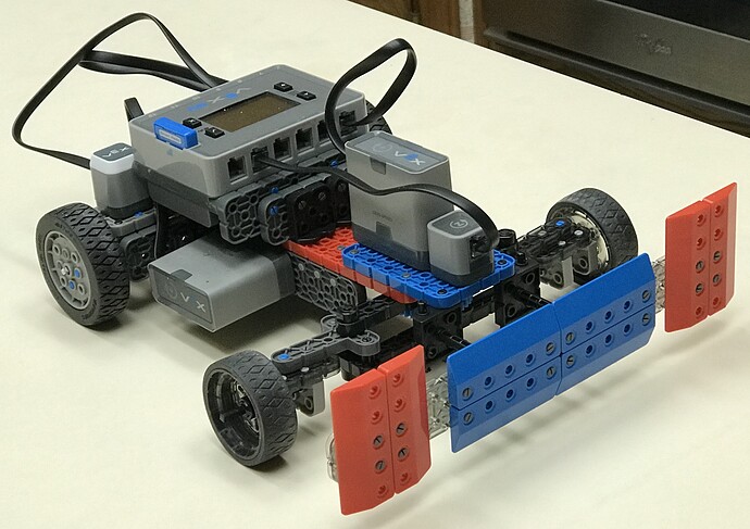

And here is the entire bot:

If you include the front bumper, it is 12" long, 10" wide, and 5" tall. From the front wheel axle to the rear is 7". From the left to right steering wheel, it is 9".
Dunno how much it weighs. The 2000 mAH battery is pretty heavy.
