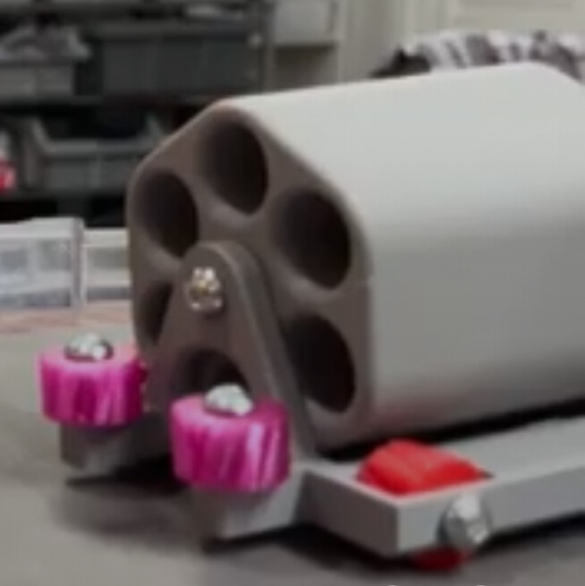

My idea was sort of a revolver type system. Saw this from a YouTube video that inspired me. An intake into a tube that can spin around like a revolver, with a pneumatic pusher to score many rings quickly. Like this:
Thoughts?
This idea is now harder to implement with the new changes to plastic, so you would need to make it primarily out of metal, which is harder to create circular shapes out of. I was thinking a linear puncher at the top to launch rings out of the revolver into the tubes.

I came up with an idea of this sort, a tube that balls were put into that was then moved around, but the revolver idea was a more refined way of doing it.
I also saw this YouTube video and I thought it was such a cool idea, but I think it will be very hard to make the barrels, namely weight balancing.

realistically, 6 barrels is kind of excessive, and hexagons are really weak, so I would personally go with a pentagon, I made a really basic sketch(see bottom) but have refined it more, basically you would use a combination of gussets, (mainly 35 degree and whatever the arc gussets are called) to make a solid C channel frame, and then you would use 1 Bar muscles to reinforce it. I was able to make a pretty solid sketch in a couple hours. (which I am not able to share due to it being literally an assembly diagram of our robot)
for the firing, I am leaning towards a Pneumatic hammer to shoot, only problem would be air budget, this design is optimized under the assumption that this game is going to lean heavily towards hoard till 30 seconds are left then score everything.
I am using a 12T pinion to 64T high strength, with a green motor for the barrel spin, might lower the ratio if it’s to slow, will see.
The lower rollers are really simple, a lot of ways to make them, I like sprockets so ours is probably going to be sprocket based.
