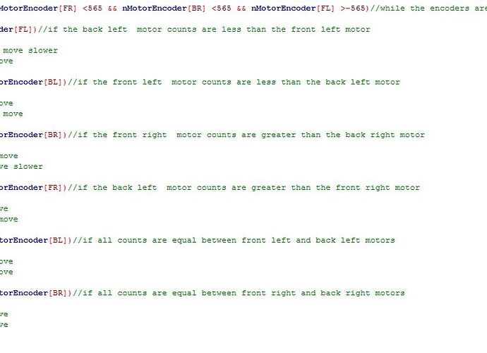

But that first piece of code isn’t working. Even though it is turning left, it would look as though one motor stops and three drift left, but that can’t be possible. Do you see anything wrong with the code?
When I took out the code and made a simple go forward until, like you suggested above, it worked, but the other part, that drifts left still happened, proving my theory that I had two pieces of code mixed up. So all along, it was the code above that travel north west code. I still can’t figure out what is wrong with that code though.
Well, lets look at what the code is doing.
You start with the while loop.
while (nMotorEncoder[BL] >-565 && nMotorEncoder[FR] <565 && nMotorEncoder[BR] <565 && nMotorEncoder[FL] >-565)
It looks like you intend BL and FL to go negative, and FR and BR to go positive.
However, the first if statement
if(nMotorEncoder[BL] < nMotorEncoder[FR] && nMotorEncoder[BR] && nMotorEncoder[FL])
compares BL and FR, if BL is going negative and FR is going positive then BL will always be less than FR. You then have two logical and conditions nMotorEncoder[BR] and nMotorEncoderFL), but these are not compared to anything so if not 0 they will be true and basically inconsequential to the test.
So BL is always less than FR and you therefore set the BL motor to -63, much slower than the other three. Depending on the forces on this motor (I have no idea what your gearing is) it may not move much, is this what you are experiencing?
Ok, I understand. Then would this code in the picture be correct? (Edit:forgot to attach it in this post, look on next post)
Thanks again!
Here is the code that I forgot to attach to my last post.
My bad again, that code has an error in it. Here is the code that I programmed with jpearman’s suggestion. I tested it and it still drifts. Any other suggestions? Thanks in advance!!!
