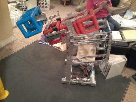

My Reverse Double 4 Bar is tilting.
So the mid section of my reverse double 4 bar seems to be tilting back :frowning: Reinforcing it and rubber bands do not see to help with this. Any suggestions?

My robot is on tilt :frowning:
Do you think maybe it’s also because I have gears between my largest gears (with arm attached to them) ?
Just wondering, when building, did you double check that you had the correct teeth placement on the gears? If possible, some closeup pictures would help a lot more.

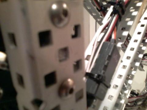

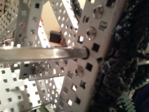

We are using the new high torque gears but not the axles. I don’t really get how the high torque axles since you can’t put them through the metal’s holes.
you do end up having to drill into the square holes that they have to go through.
the large axles WILL make a huge difference in the quality of your build and with your original problem. I am actually really surprised that you have a working dr4b without large axles.

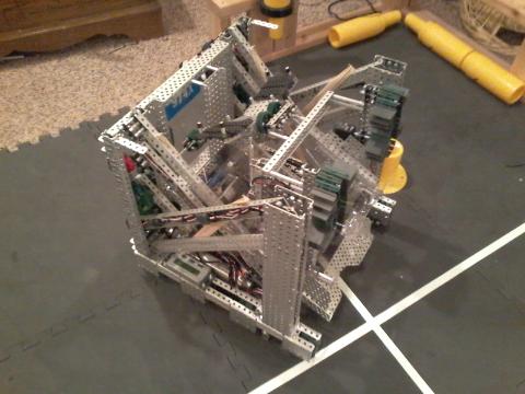

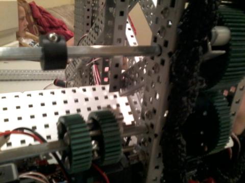

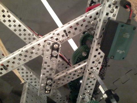

these are some pictures of my teams dr4b arm drive assembly. if you want to stay with your gear set up, I would put high torque axles and gears on all 4 gears connecting the two lifts together because there is a lot of torque between them and you don’t want them to come out of alignment during a heavy match. otherwise, you can do what we did and gear 2 directly and then bar in the gear to the top 4 bar. less moving parts and less slop.
-Cyberbrains
foregot the the pictures.
here
you just did. :wink:
I can’t be sure from the picture but I think that your joints at the top of the six bar portion are not in a straight line or the spacing between the joints are different from the bottom.
Nah they’re the same. It’s the slop in action.
