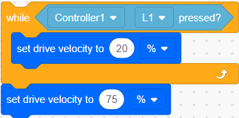

My robot has spasms, Please help with ideas, or fixes
This line of code causes my robot to have wheel spams. It is in a forever loop. It works if I use drive stopping, so it would normally work. Is this an issue I can fix if I swap it to text? It only goes forwards, and if I try to go backwards it starts having spasms. Same with turning
Can we see all of the code please?
if you are trying to make a low-power mode with the press of a button, then use an if/else block. it should be something like the following: if controller L1 is pressed, set drive velocity to 20%, else, set drive to 75%, then put that in a forever loop. if this isn’t your intent then an explanation or more code would help.
This is it. It has a drivetrain and controller set up. That is all.
Could you use a wait until Controller1 L1 Pressed block instead of a while loop?
The constant setting the velocity to 20% may be messing with the robot.
Can you explain what you are trying to do? Foster would say this is the XY problem since none of us are sure what your goal is.
and if you are trying to control the drivetrain by assignment to the controller that will conflict with these blocks. You really have to choose either simple graphical setup and assign the drive to controller joystick or use blocks to program it.

The first thing you should know is what happens when you configure the joysticks to drive the robot. Supposing you select tank control, it generates pre-written code in the background that looks something like this:
while (true) {
  set left drive velocity to left joystick position
  set right drive velocity to right joystick position
Then in your code, you put alongside that:
while (true) {
 set left and right drive velocity to 20%
Obviously, those two infinite loops conflict each other. One sets the velocity to your joystick position and the other to 20%.
It gets worse. You say,
As you may have figured out, this is because one loop sets the velocity to something like -100% and the other to 20%, so it’s constantly switching back and forth between forward slowly and backward quickly, which is what you describe as “spasms”.
While it would have been nice if you had explained better, I’m assuming your goal here is to have a button which, while you press it, slows down the robot so you have greater precision. The only way I can think of to do this is to stop using the default drive-train and controller configuration. Something like this:

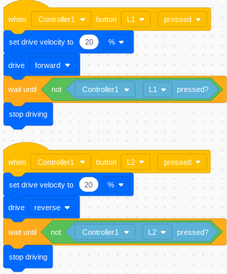

I have 3.5 hours of time later, I will test to see if this works. Thank you!
@242EProgrammer
|322px;x388px;
This made it so when I press L1/L2 I go forwards/backwards. It works great and adds extra torque instead of speed.
Uhh, I’m pretty sure code can’t add torque. Torque is physical strength, and motors, I think, don’t get physical strength just because they’re slower. Somebody?
I’m also curious if it worked; I believe it only set the drive velocity to 20% once, so the background joystick code would overwrite it with constantly setting the velocity to zero. Try driving forward with the controller, pressing and holding L1, letting off the joysticks, and after a minute, letting off L1.

This is what I was wanting to do, but we found a solution. Thanks to everyone for their contributions!
