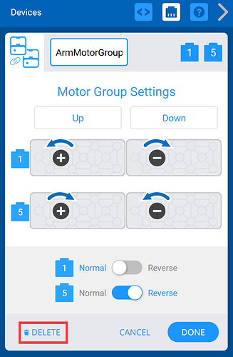

One way to change which direction the motor will spin is to use this menu:
Flip the “switch” on the bottom to reverse if you want to reverse the motor’s spin direction.

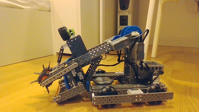

Be sure to reinforce the BACK of the chassis. Otherwise it WILL tear apart, and at the worst time.
