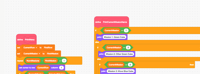

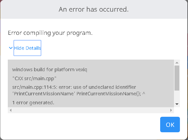

We have a MyBlock calling another MyBlock, and the project fails to download with compile errors. TankAutoWithMenu.iqblocks (91.0 KB)

I think the problem is not specific to this project but has to do with the fact that local functions corresponding to MyBlocks are defined but aren’t declared upfront, so depending on the order in which they’re created(?), you get undeclared identifiers at compile time when you have a MyBlock calling another MyBlock.

It’s a forward reference issue, I need to get the blocks team to deal with that. For now, make sure the PrintMenu block is below the PrintCurrentMissionName block.
Awesome! Thank you so much!
