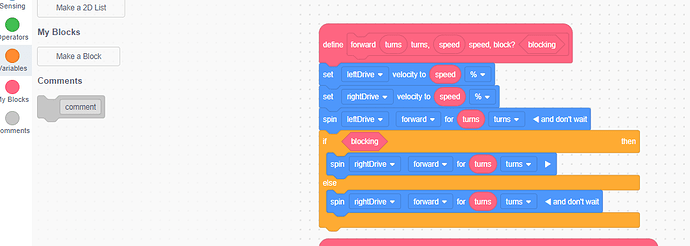

MyBlocks disappearing?
I have defined functions but they are not showing up for use…???
Hmm… Not sure what is going on here. We’re looking into it.
Thank you for reporting this. We were able to reproduce this issue, so we should be able to find a solution.
Until we release a new version with a solution, it is possible to get the blocks back in the list of blocks by doing any of the following.
  • opening/closing the robot configuration view
  • opening/closing the command help view
  • editing a My Block
  • adding or editing a variable
  • close and reopen the project
Thanks. I am able to get the blocks back as needed. When I opened the computer this morning, they were there. I maximized the window, and they were gone. I created a new MyBlocks, and they reappeared.
This issue is resolved in 1.0.8. Sorry about the issues!
