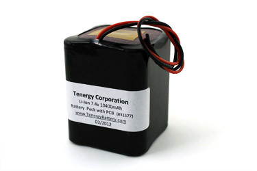

This is 10400 mAh rated.

Here’s a bulky 7.2V 10000 mAh NiMH pack.
[Tenergy Power
What dopes the robot do? Does it move? Would lightening the robot a bit help with the power usage? Would implementing slew rate code (jpearman’s) stop current spikes on the initial movement that might use a bunch more battery life? (Kind of like stepping on the gas in your car)](Tenergy Power)
