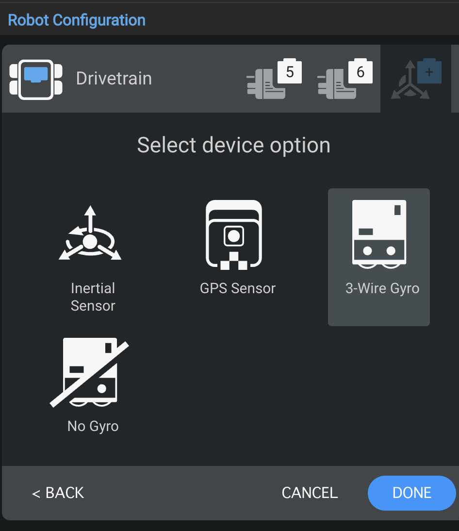

Make sure the inertial sensor is configured in the drivetrain in motor and sensor setup.
I’ll have him look into that. Would that be causing the drivetrain to spin indefinitely rather than 90 degrees?
If the inertial sensor isn’t configured with the drivetrain it will continue to wait for a reading from the inertial sensor that it will never get.

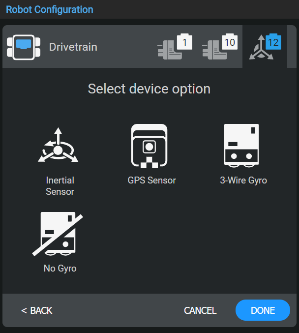

Here in drivetrain settings you need to add the inertial sensor.
I believe he has done this already. I took a look at the motor configuration and this is what I found:
