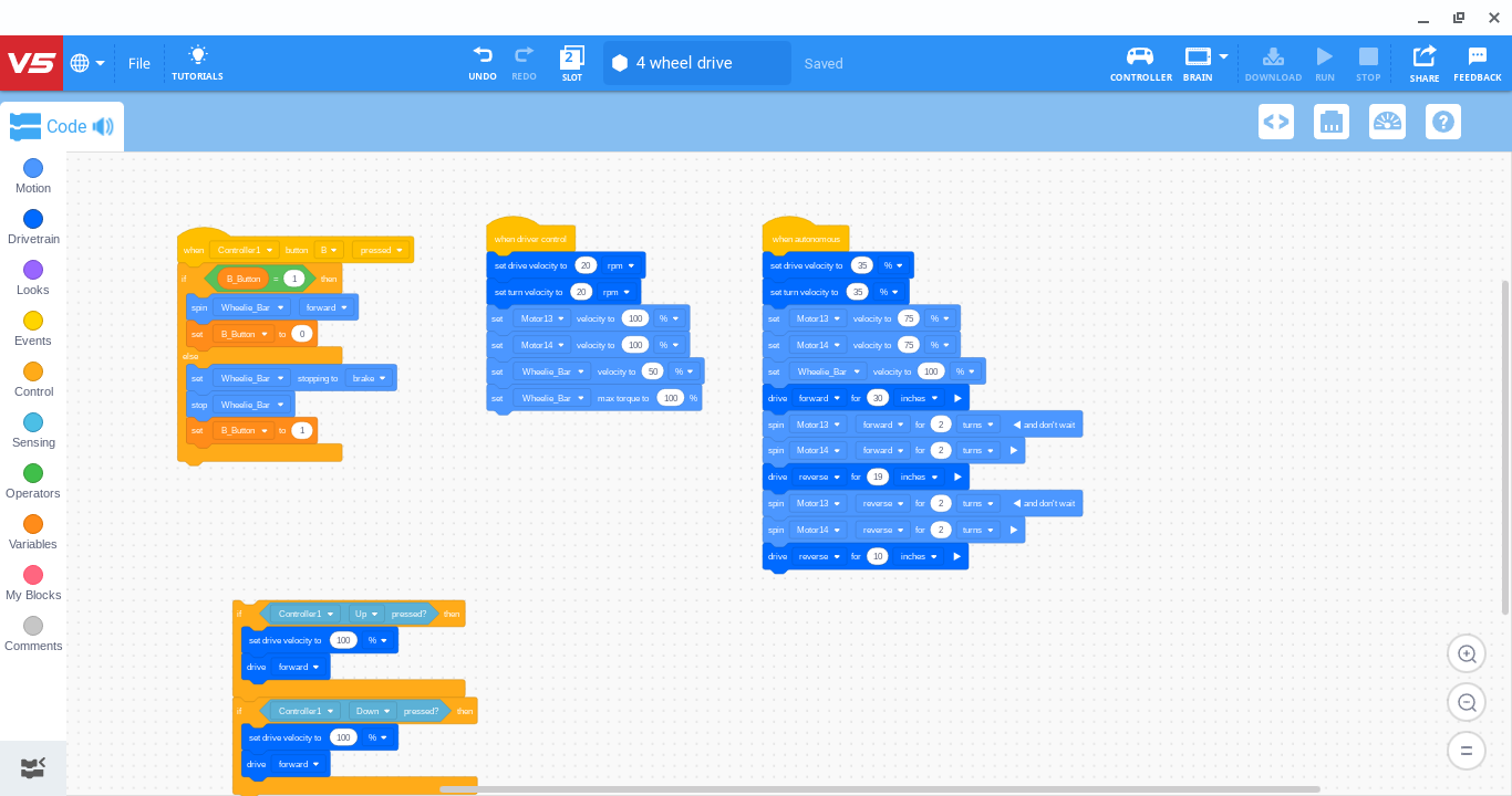

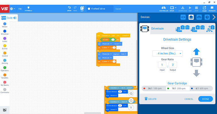

ok so my other teamate had programmed the drive train for our bot. well i was given the job to install the four wheel drive. so the four wheel drive is in but when i programmed it from 2 motor to 4 motor the thing wont drive at all. i have made sure the controls are set and the gear ratio is correct. what did i do wrong?

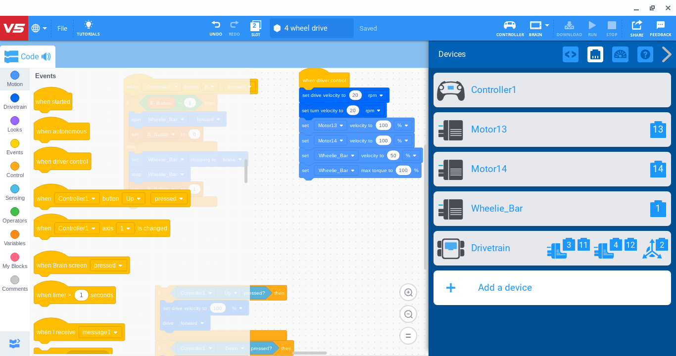

btw the motors dont go at all its not like they go anf get stuck. they just wont turn no matter what i do. all the other functions (i.e my forklift and tailbar) work fine. but both my wheel motors and the extra two motors that turn the front wheels dont work

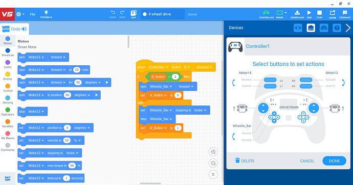

You haven’t set the drivetrain to a control.
Click either of the joysticks icons on the controller in the device setup part of VexCode, it should give you a few different drive options, keep clicking to scroll through them.

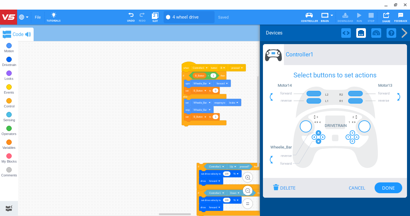

You don’t have the drive set up on the controller
I have tryed to set up the joysticks over 3 times. i have selected the way i want they to move and saved it. it still doesnt work

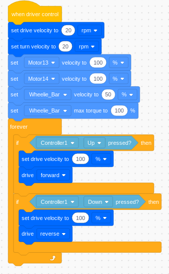

Your block of code that turns the motors isn’t attached to a condition. It is essentially dead. You should put it under “when driver control” or “when started” (the yellow blocks with rounded tops).
i attatched it and added the forever block. still doesnt drive
ok i take that back. when i press the arrow buttons ( up and down) they will continue driving until i hit the oppite button and then it will continue repeating that until i end the program. there doesnt seen to be a "controller1 {joystick direction} pressed? " block
If you want to use a joystick, I’m not sure which section it’s under, but there is a variable that tells you the value of the joystick at that moment. You would use that variable and just say something like “set drive velocity to (joystick value)%” and “drive forward”.

If you want to code your joystick driving in blocks, there is a round-ended block that says something like “Controller1 axis 3 position” which outputs the forward-backward position of the left joystick. All the way forward is 100 and all the way backward is -100. (I would guess. Full disclosure: I have only ever done VEX IQ and I only used blocks for a short while. Therefore, all of this is really just my educated guesses. You will want to print the controller joystick output to the brain and test first.) If you wanted tank drive, you would say, “Set left motors’ velocities to Controller1 Axis 3 position.” If you wanted left-stick arcade, you would say, “Set left motor velocity to Controller1 Axis 3 position - Controller1 Axis 4 position.”
Since you are using buttons right now, you will want to say, “If I’m not pressing ButtonUp or ButtonDown, stop driving.”

My sinceres apologies to you. im a absolute idiot and thought when you click your joystick button on the controller menu, you had to choose each time the directions came up. so i clicked on which button i thought was right until they didnt come up anymore. i thought that meant it was programmed. in actuality, those were seperate options for how the bot was controlled. im a complete idiot and im sorry for waiting your time :frowning:
