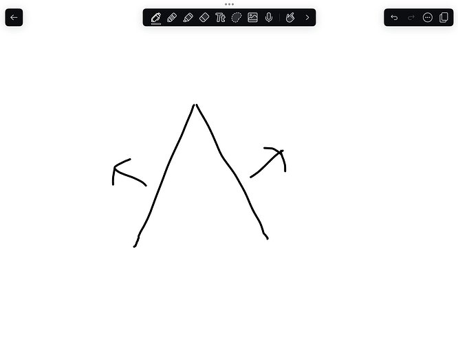

Need help creating a joint on robot
Hi. I’m currently working on a project and I’m trying to build something that can open and close like a cabinet. I will be using c-channels for the cabinet part. I would like if someone could tell me how I could make a joint like a cabinet for this. I have attached a very badly drawn picture of what I want. The lines represent the metal and they need to be able to open and close back up again. Thanks for the help.

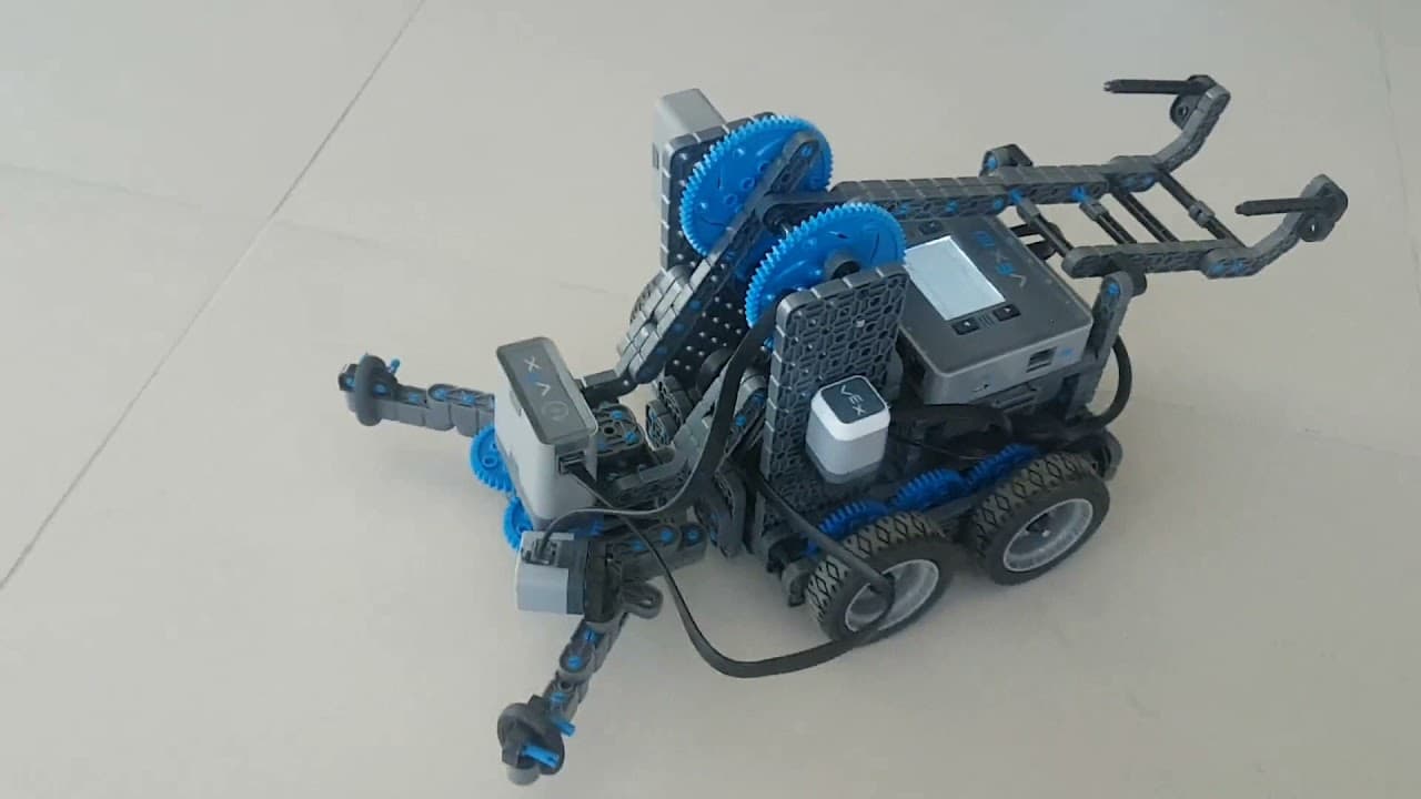

In case you want another suggestion, you can try designing the claw on the vex iq clawbot, but with vrc parts

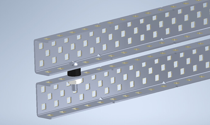

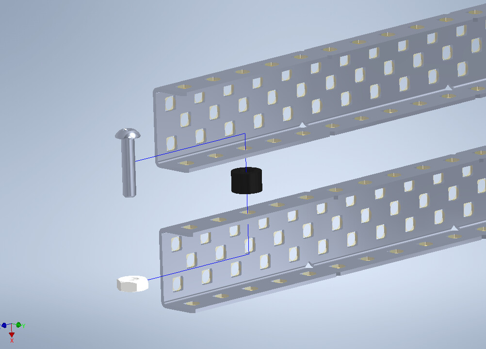

Simple hinge with a screw and a spacer.
This is pretty much what i did today. Just connected the gears together and connected them to the c-channels. Thanks everyone who tried helping.
