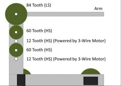

My team uses a similar design. Attached is a picture of our design. All of the gears are high strength.
You could also add another motor.
tutman 96… We had a similiar design before I changed to chain driven… Kept having the gears slip… But also b/c I had small gears on the bottom not big gears… That might help!!! I might have to go to the orginal idea… Where would you put your motors? Did you have one powering all that?I mean one for each arm, or did you have 2-3 on each side?
Your arm is geared much too fast. Here’s a pic of “classic” VEX arm gearing – a 12-tooth gear driving an 84-tooth gear bolted to an arm. The robot in this picture uses latex as a “counterweight” and lifts the arm with a single 3-wire motor.
This was built before the 12-tooth steel pinion gears were available (you can just see a red 12-tooth VEXplorer gear in the pic) and the 84-tooth gears were doubled-up.
https://vexforum.com/gallery/files/2/0/9/1/cimg6338.jpg
Well I ditched the chain and went back to the good ol gear system like you showed me… Success!
I have 2 per side on the 12 tooth gear
