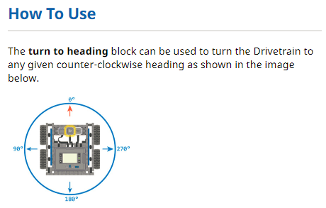

It moves forwad until within 5 inches moves back 5 inches and it says turn 90 degrees but it never stops turning
You set the heading to 0, and then want it to go to 180 near then end, so this should make it turn around.
One thing I don’t like about using a drivetrain is that you can’t access the motors or gyro outside of the drivetrain class. So if you want to use a gyro in the drivetrain you can’t get the heading or calibrate the gyro. If you have a calibration issue there’s not much you could do about it.
I don’t see the 90 degrees. And do you mean that it is turning and just keeps spinning and spinning and spinning???
I remember there was a way to do it without a gyro i did it first try but deleted the code by accident
I am sure you’ve checked, but is Front / Back correctly designated in drive train settings? A student encountered a similar scenario to what you are describing. He had inadvertently placed his machine so that it ‘appeared’ to be moving forwards and backwards. When turning the machine would endlessly spin as the value from the gyro was different to expected. Try reversing Drive Chain direction.
