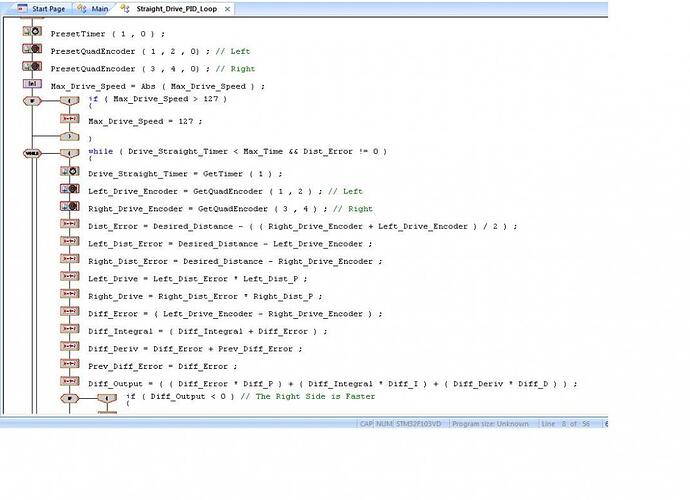

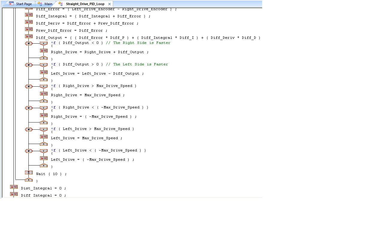

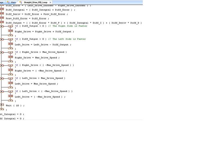

So I took a shot at writing a program like this in EasyC V4. It uses a proportional loop for calculating the speed of the motors depending on how far the distance is and it uses a PID loop to make the robot go completely straight. THe only thing is, I can’t test it on a robot and I really want to know if it will work. I have attached the pictures of the entire code. If anyone can tell me how it will do and if I need to make any changes that would be great because I understand PID but I still don’t get how to apply the Output of the equation. Thank you very much!
Edit: I forgot to put that the parameters for this function include: ( Desired_Distance, Max_Drive_Speed, and Max_Time)
