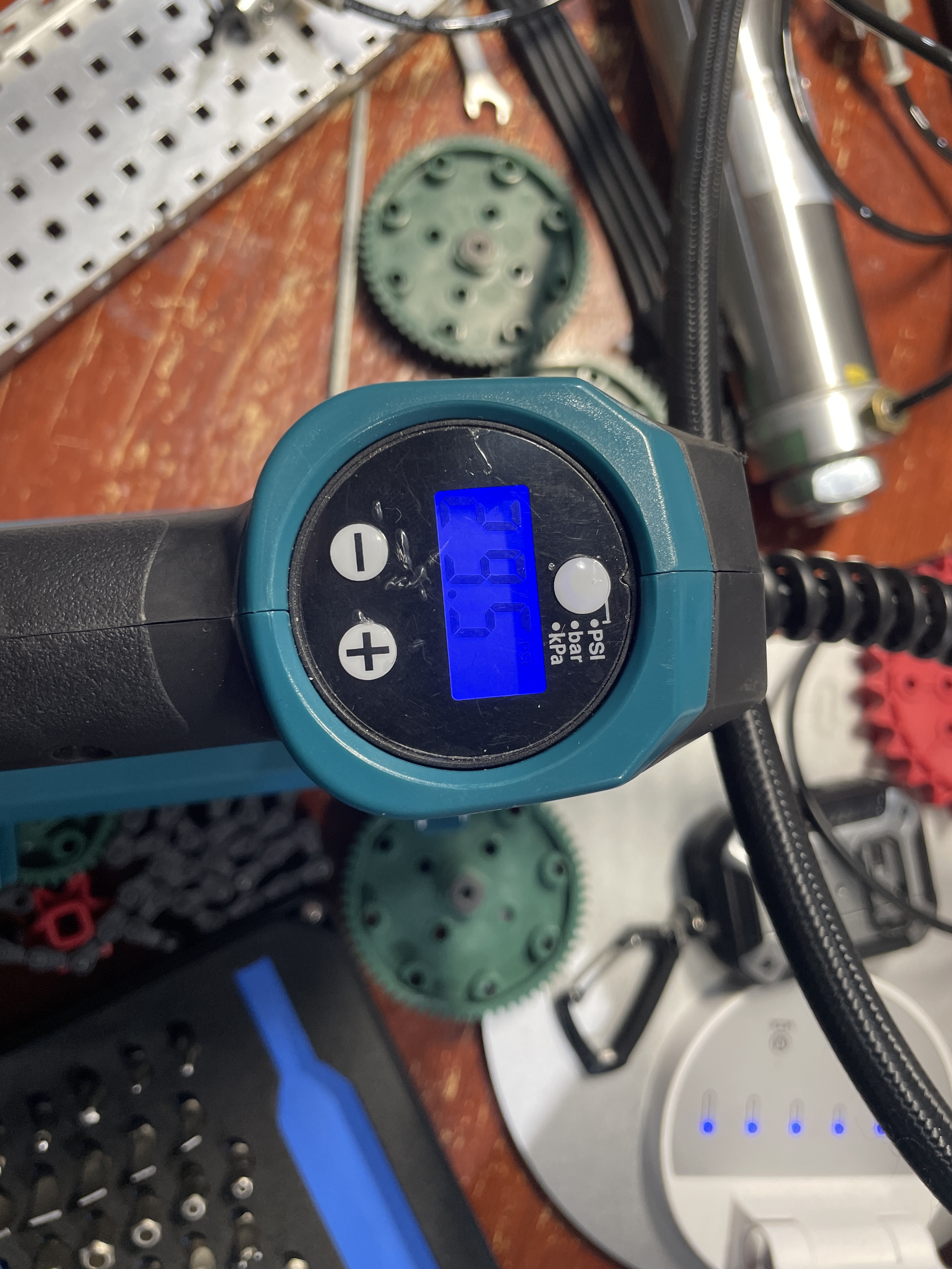

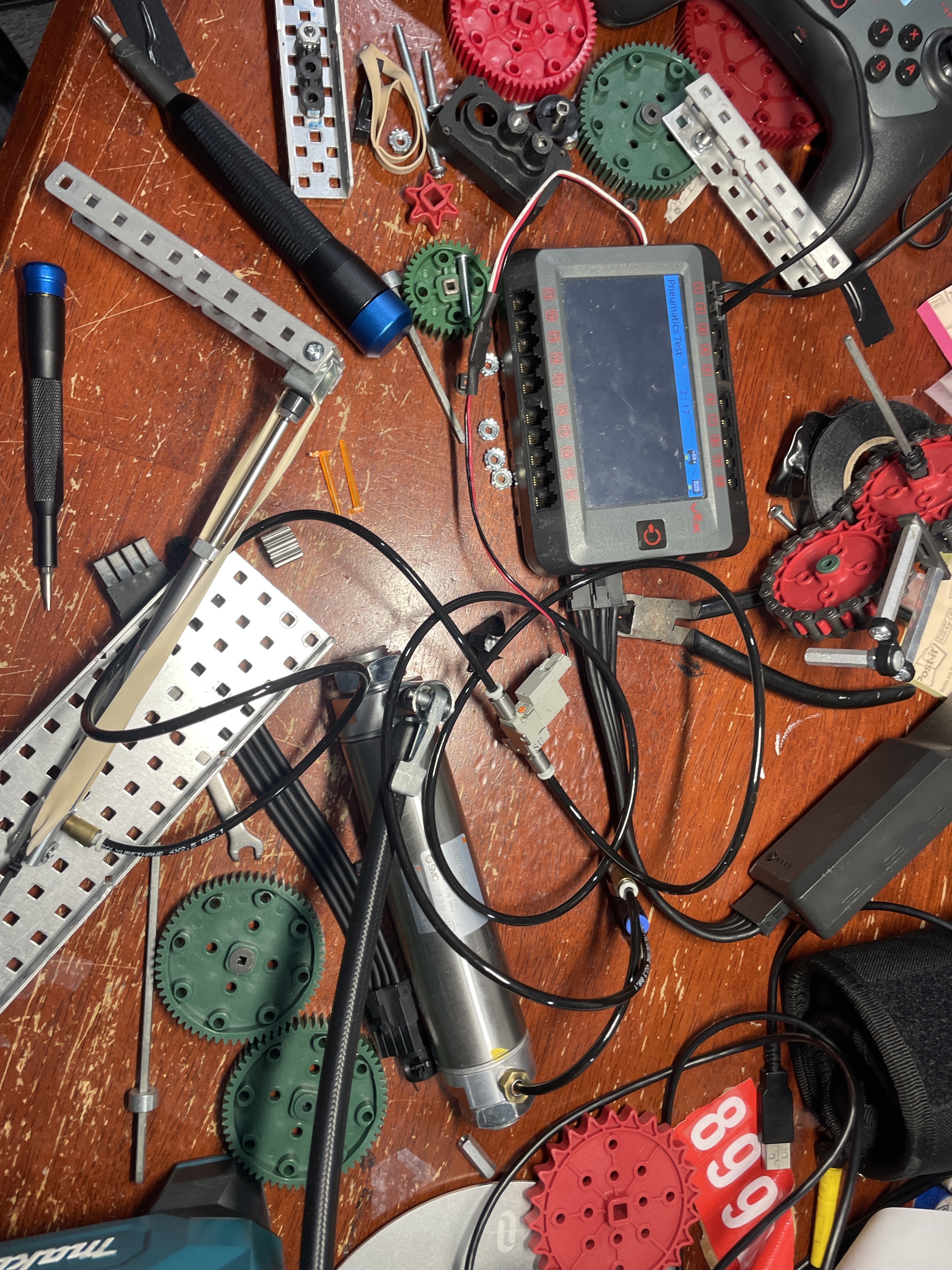

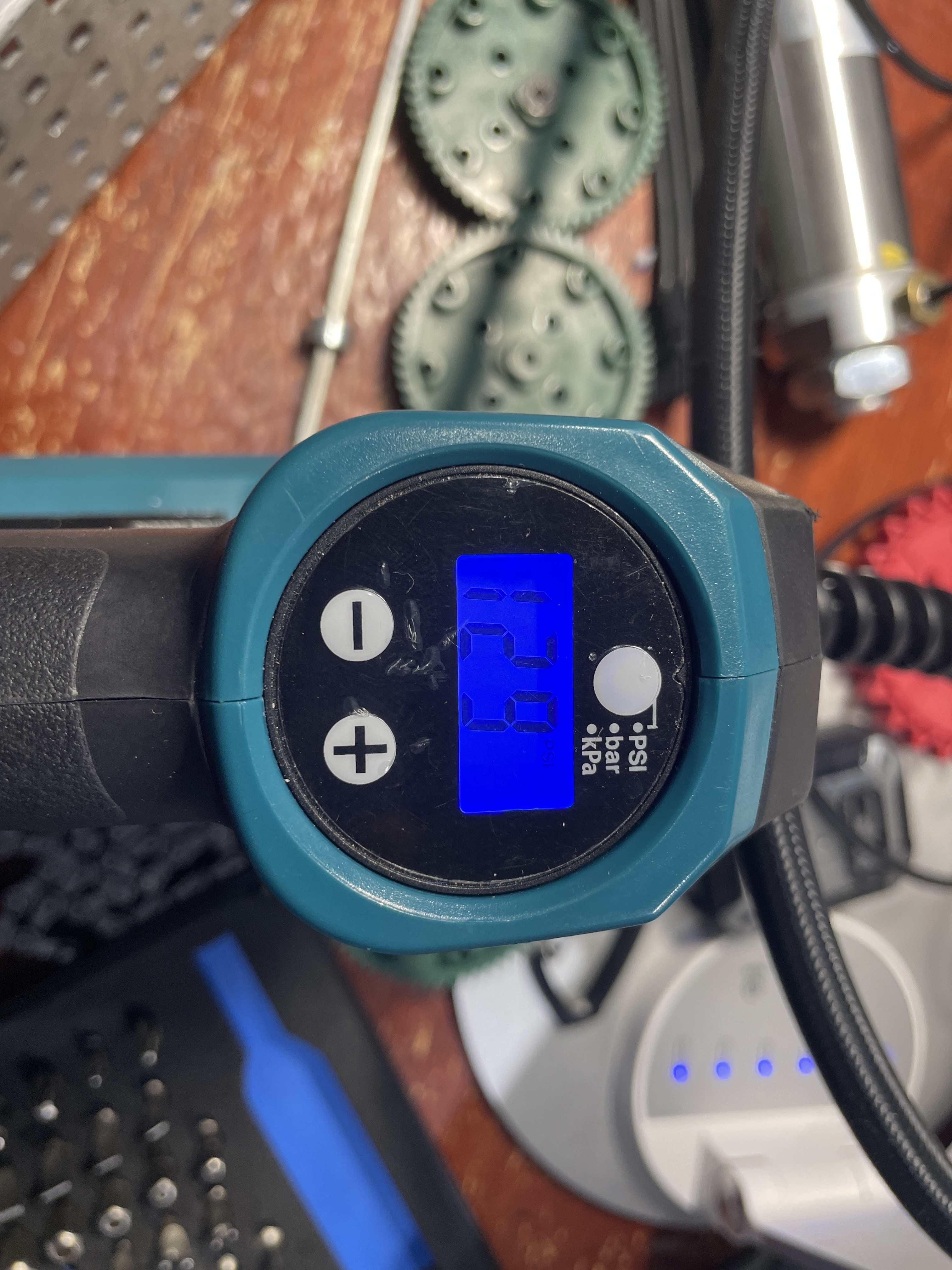

So i have my first pneumatics except they keep losing air even if im not using them. I’m using a single action and it looses air too fast.
I tried using the pneumatics in the second and it dropped from 129 to 25. (i know 129 is an illegal amount, just testing) Can anyone help?

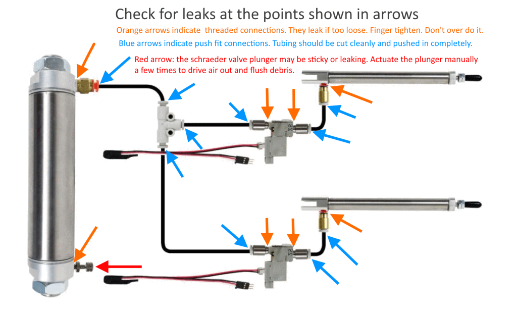

Take a look at this diagram of the legacy pneumatics system with a single action cyclinder such as yours.
Go through your system and check every single spot carefully and thoroughly. It’s there somewhere, and you can find it.
That’s a great diagram. Do you mind if I or others use it?
The diagram without the leakage annotations (which are very comprehensive) comes from this VEX Library article if you’d prefer to use it without the annotations: https://kb.vex.com/hc/en-us/articles/4404204973076-Legacy-Selecting-a-Pneumatics-Kit-for-the-V5-System
Its a learning tool. Use it at will.
