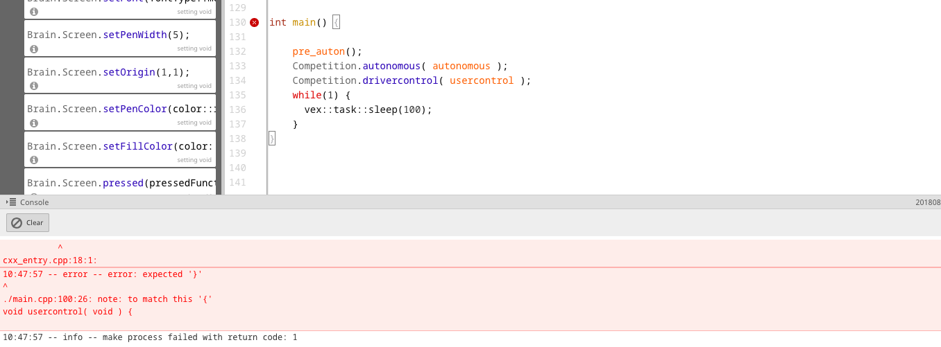

Need Help with this error message
56%20AM
Does anyone know how to fix this, or does anyone else have this problem?
You have deleted the closing } for usercontrol ( void ), which is why the error message refers to line 100 while marking line 130. The error is highlighting the line at which the code failed, but also telling you where to look for the actual problem.
ok thanks!
