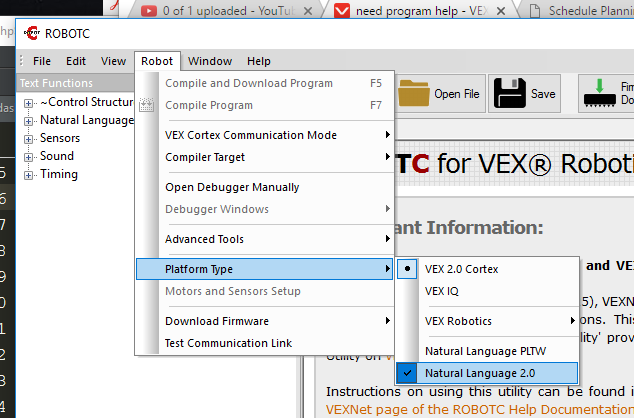

I tried your 2nd code cody but I got erors for the setMultipleMotor command it is an undefined variable
This…
I’m still getting errors for setMultipleMotor in natural language
(thanks for the help cody I’m still somewhat new to programing and this is my first time using potentiometers)
So what’s the “repeat(forever)” supposed to do even though it’s already inside of an infinitely running while loop? Another thing, you are using curved brackets “(” instead of normal brackets “” when it’s about sensors and motors being defined (edited)… Let me see what I can do, but this may be SOME of the errors fixed:

Hopefully this helps/works :slight_smile:
