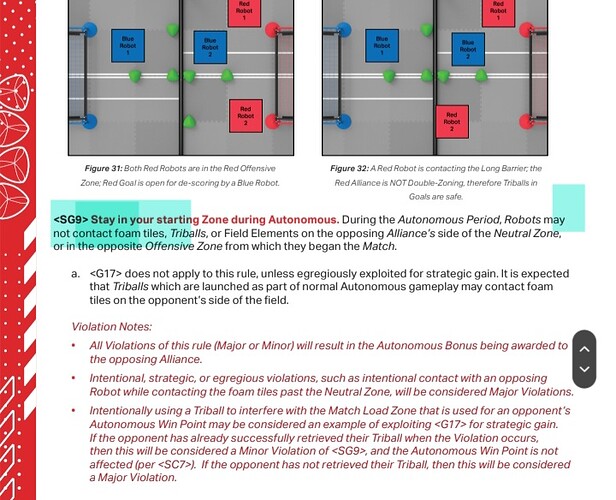

What part of <SG9> makes you think this isn’t allowed? Try reading the rules more carefully.
The triball is on the line, not in either zones (or both), so contacting it is legal.
Since the wing did not contact the ground/field tlew on the other side of the line, it is legal. The rule does not prohibit passing the line as long as the mechanisms passing the line are above thr ground
