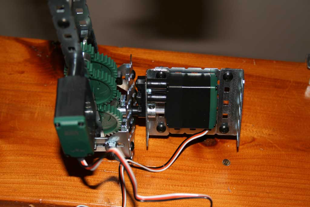

After updating to the latest firmware and RobotC we have experienced a noticible reduction in motor strength. The problem appears to revolve around the “setMotorStrength” command. We removed the “setMotorStrength” commands from our program and noticed a marked improvement, however strength is not equal to what it was prior to the update. We have observed the same behavior in two different robots. The robots are not of similar design, but both have lost lifting ability.
