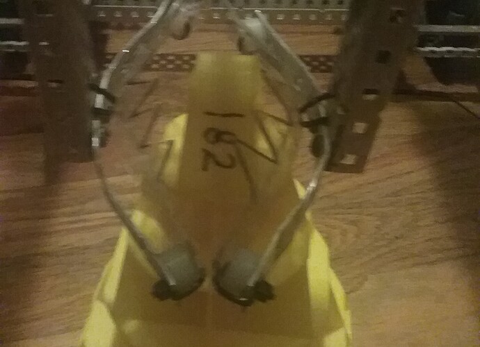

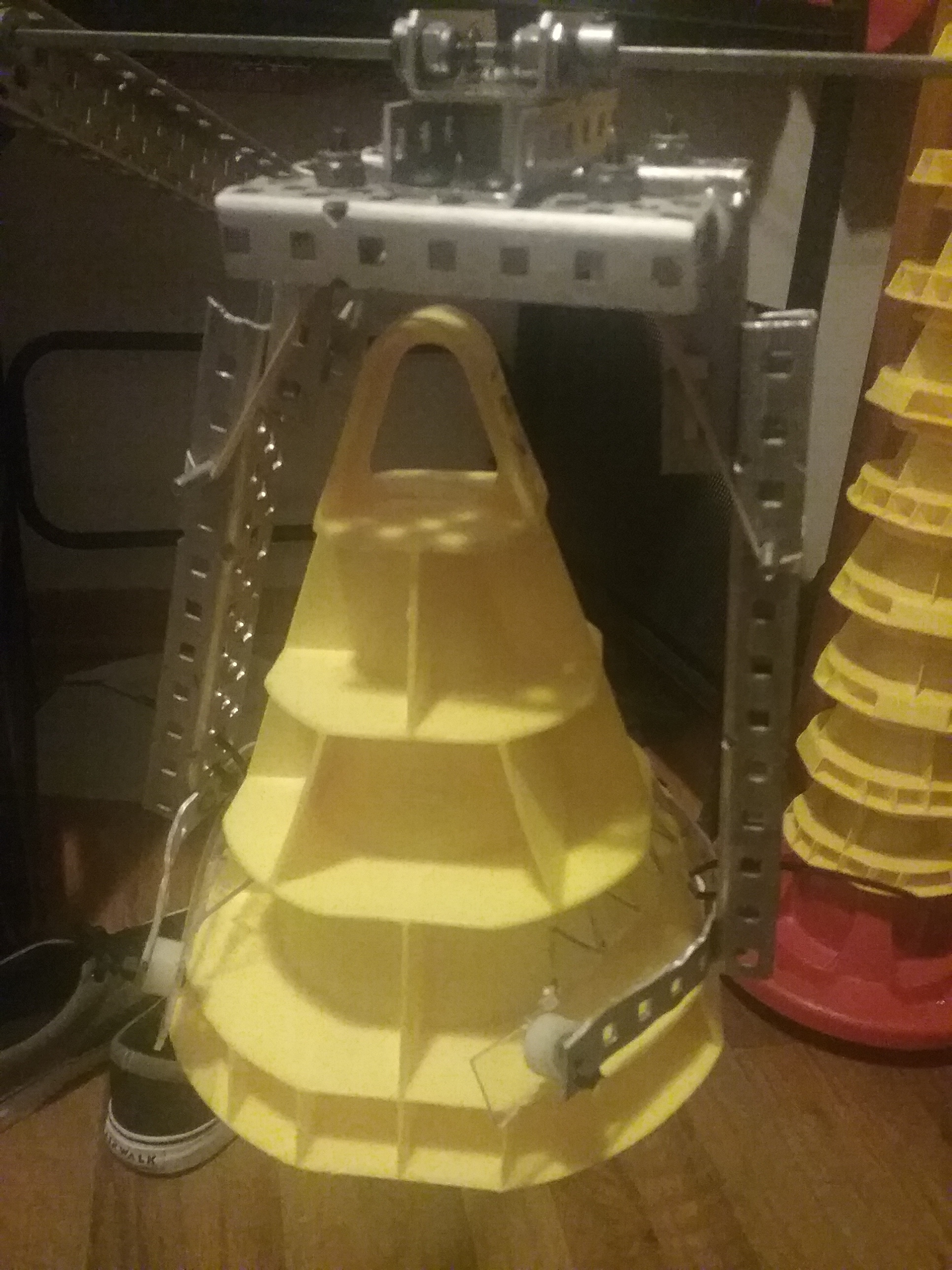

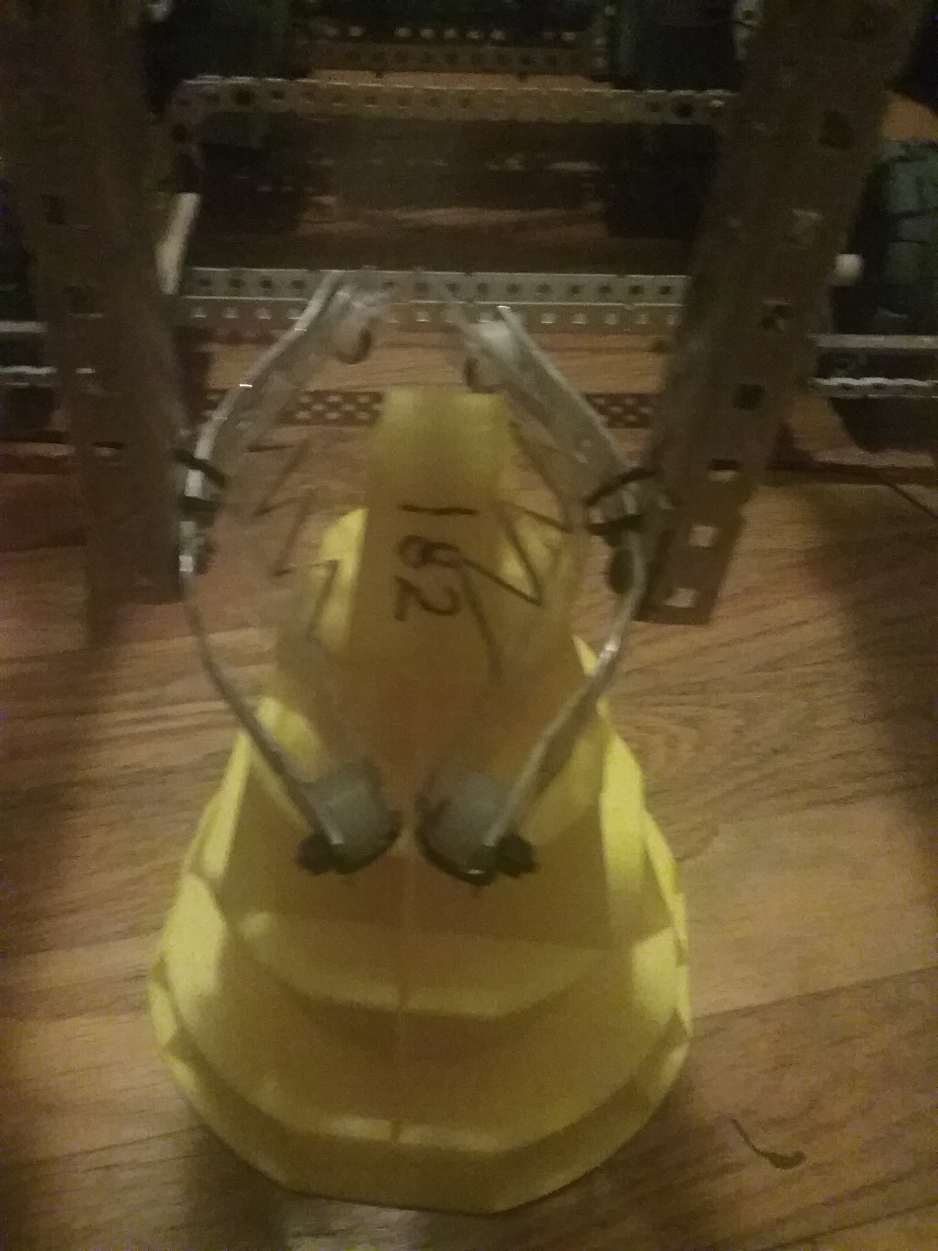

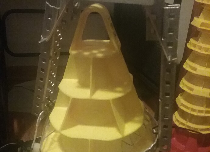

Ok, so I’m assuming most of you have seen some of the better passive intakes that are currently out there; like 7700R and 6007, to name a couple. The problem with most passives, however, is that they usually have to be mounted facing inward to be able to release the cone onto the mobile goal stack. There’s also been a thread recently made about how not being able to score efficiently on the stationary goal is a major drawback to a passive intake. Because of this I decided to make a passive intake that could release a cone from the front and the back. This is the result. I’ve been really busy with school for the past couple weeks so I haven’t had time to tune it very much but right now it’s able to pick up and hold a cone perfectly fine without dropping it and it fixes the problem of not being able to score on the stationary very well as both the front and the back of the intake are basically the same(of course there’s some human error when cutting lexan/polycarbonate/whatever, bending the one bar, etc). I’ve just taken some pictures(sucky ones at that) for now but if there’s enough demand I may make a video of it after my next competition. So, questions? comments? suggestions? Post below!

A video thats just a 360 degrees view of the intake would be helpful. It looks really nice though, but how reliable and quick is it compared to other designs from your testing, such as Goliath rollers or a claw?

It’s actually really reliable. I mean I still have plenty of room to improve it but I’ve been really happy with it so far. As far as testing against other things: It doesn’t have quite the room for error that a goliath intake has. It’s basically the same as a top down claw so there’s not much change there. I did have to add some extra metal on it and haven’t had the time to switch some stuff to lexan for weight but once I do that it should be lighter than a motor claw and a goliath intake.

Nice! Thanks for the video! It looks great. Just a little tip for the future though, instead of opening it to drop the cone, just pull it out from the front or the back. Just to show how easily it comes out. :wink: Thanks though, wish I could see it at Portage this weekend, but I see you won’t be there. Good luck at your tourney though.
