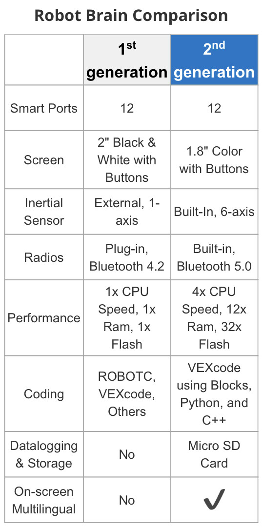

For my personal interest, is there anything you do like about the 2nd generation of VEX IQ?
Great, that helps a lot with my understanding here. Sounds like this will make sure there is a level playing field between the V1 and V2 batteries.
Absolutely, otherwise I wouldn’t be so interested in getting information about the new system.
  • Color screen is great
  • 6 axis improved IMU being built right into the brain is an awesome addition, especially for the price.
  • Integrated radios makes a lot of sense vs radio chips that can easily be lost
  • Additional inputs on the controller is always good.
  • Always love to see Li-Ion batteries replacing NiMH. Stable voltage and much larger useable capacity are extremely useful in the context of education and competitive robotics.
  • Glad to see laser rangefinders being added, this was one sensor the mindstorms system has had for a while now and I’m glad to see IQ get it.

On that note, I am curious as to how much this change actually affects gameplay, or if it is mostly just more user-friendly. Because going by the numbers, it is more like going from an iPhone 5 to an iPhone 12, but I’m curious if my original comparison holds up better in the context of how it affects a robot in a competitive environment.
It’s not going to make a student a better driver. or a better robot builder. Driving around a 6 motor robot using either generation brain and controller will be the same for the vast majority of students.
The generation 1 IQ brain, despite having limited resources, could do some cool things, it’s always been a fun system and that will not change.
Will the overall experience of using the generation 2 brain be better ? Well I hope so, no more “I2C error detected on motor port 9-12” please reboot messages, better sensor dashboards, logging of errors in a similar way to the V5, many other small UI improvements. It’s better in a similar way that a 2021 car may be better than a 2011 car, still gets you from A to B but has the benefits of being 10 years newer.

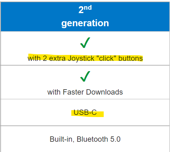

The comparison page lists “wireless downloading” as a feature of the Gen 2 controller. Does this work the same way as wireless downloading with the V5 controller (i.e., connect the controller to a computer via USB and download code over the robot-to-controller link)?
  • Will printing to the console over the wireless link be supported like it is with V5?
  • Will the Gen 2 controller support wireless downloading when connected to the Gen 1 brain?
