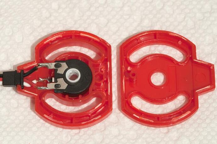

Time to take one apart and see what is inside:
IMG_9337
here is forum post:
