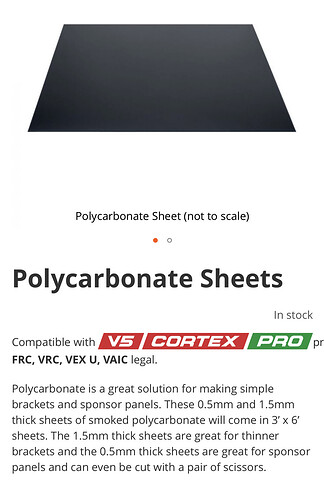

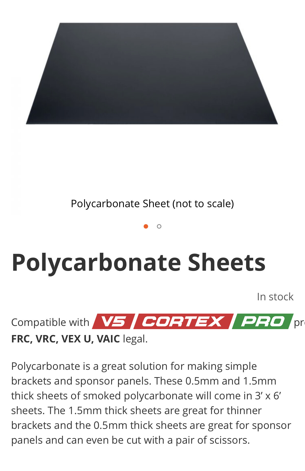

I think the wording of “Custom-Made” would make this exempt from R9
-Vex official website
So It should be perfectly legal to use as much of this as you want. The issue might be if you cut it or make modification. then it will be up the QnA to decide that.
There is no reason this would be an issue. These are legal VEX parts. Use as many as you like. Modify them how you like. No different then other VEX parts.
I feel like it could be that it might then become defined as a custom plastic part
It would not be. You are allowed to modify any official VEX parts (except those that are excluded, such as electronics and pneumatics). If you took a gear and cut it down until it was just a piece of flat plastic it would not suddenly become a custom plastic part counting towards your plastic allotment, it would just be a modified gear. This is no different.

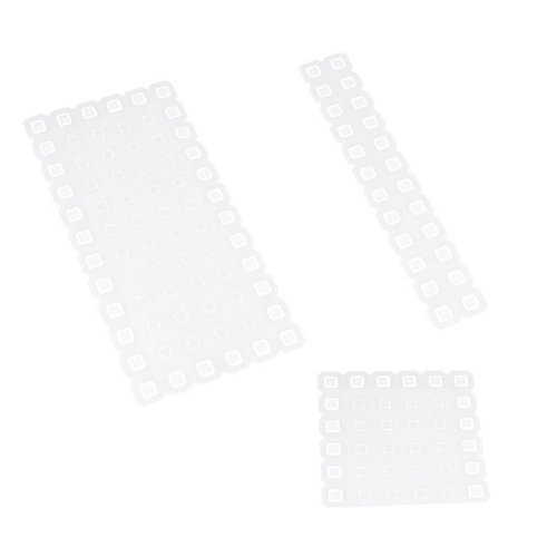

I noticed that some of these are 6x12 and 6x6 instead of multiples of 5 like the other plates. Is this similar to how exp metal is in 4 hole sections?
Powdered metal, heated to just before melting into a smooth mixture. Contains pores/holes for lubricant.
