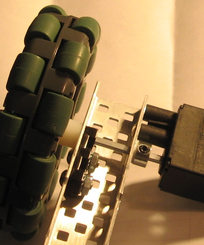

Replace each pair of Chassis Rails with a single piece of C-Channel. C-Channel is good (Use your Tarzan voice to say that part)
[INDENT]
  • Put the 2-hole side of the C-Channel on top. The “C” will open downward.
  • Put motors on the inside of the bot, gears and wheels on the outside.
  • Mount a Flat Bearing block inside the “C” of the C-Channel for the motor. Mount another on the outside for the Wheels/Gears.
  • Arrange the Bearings so that only their end holes overlap (Axle obviously goes through the end holes). That makes it possible to tighten the inner Bearing’s Screws (the Motor Screws) without removing the outer Bearing’s Screws.
  • Put a Shaft Collar and a 1/8" Nylon Spacer inside the “C” of the C-Channel to keep the Axle in.
  • If there is no gearing on the outside of the Bot, put an 1/8" Nylon Spacer between the outer Bearing and the Wheel to avoid collisions between Screw Heads and the Wheel.
  • Put a Shaft Collar outside the Wheels/Gears to keep them on the Axle.[/INDENT]Both the Wheels and the Gears can be now be swapped out by just loosening the outer Shaft Collars.
This will probably take about 1/2" off the width of each side (If you move the C-Channel closer to the center to get full overlap with the Chassis Bumper you will lose another 1/2") and consequently affect the handling characteristics a bit. I say no big deal, but if you want to regain that 1/2" (or make any other width adjustments, replace the Chassis Bumpers with pieces of 1x2x35 Angle (or 1x2x35 C-Channel or 1x3x35 Angle) cut to whatever length you like.
Blake
[Edit]I forgot to point out that the motors are thicker than the C-Channel. When putting on Chassis Bumpers, or the equivalent, you can’t mount the Motor at the end of the C-Channel (the way it appears in the picture I attached to this post).
Instead you would need to rotate the motor so that it’s bulk is in the interior of the chassis instead of at the end of the C-Channel piece.[/Edit]

  • Replace the motor bearing, clutch, axle retaining collar, 1/8" washer, and motor axle with a longer axle, clutch, teflon washer as normal in clutchless setup. This shows that motor socket can be used as a bearing.
  • put outer bearing block inside the C instead of outside next to wheel to reduce the cantilever moment arm of the cantilevered wheels.
    [/INDENT]
    This provides the opportunity to learn if clutches provide any value, and if so, an opportunity to learn how to replace motor gearheads.

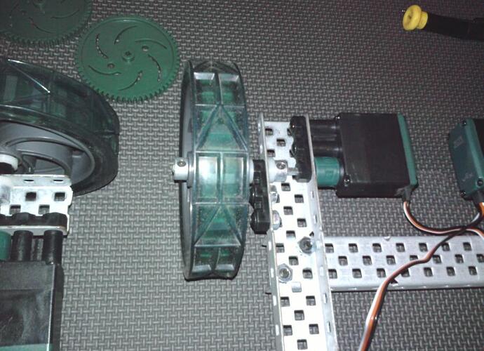

Version 2: (less well though out, trying to avoid cantilevered axles entirely…
Same extra parts as Blakes, one pair 1x2x1x25 C channels each.
[INDENT]
  • Use C’s to replace or augment the bumpers, so that they reach across all 4 rails.
  • Place wheels between rails so they are not cantilevered. (yeah!)
    [/INDENT]
    This should works fine if not using gears.
    Outside rails shield wheels from running over game pieces, allow sliding along walls better, etc.
Pardon the slight off topicness of this post, but what’s the problem with a well supported cantilevered wheel? I think for the particular application here (light, simple robot with as little additional pieces as possible), cantilevering wheels is not a problem.
Roboteers could consider taking a page from the Squarebot and moving the rails so they’re both inside the robot. All you’d have to pay for would be bearing rivets (which if you couldn’t tell already, are awesome!)

My SAT score must be slipping as I get older - I need a picture - Can you post one here in the next few days for us?
Let me try one more word picture first.
  • Remove the clutch from the motor
  • use short motor screws to fasten the motor directly to metal (no bearing)
  • Fasten a flat bearing block inside the C, with screwheads on the wheel side and nuts against the bearing.
  • From outside to inside, the axle stack is this:
    – Outer shaft collar to hold wheel on.
    – wheel
    – spacer washer to keep wheel from rubbing frame and bearing bolt heads
    – outer edge of the C frame
    – bearing on the inside of the C frame at the outer edge
    – inner edge of C frame (If axle corners scrape the metal, this frame hole could be enlarged.)
    – teflon or other low friction washer
    – shaft collar to hold axle into motor
    – motor axle socket, which acts as inner bearing for lever loads from wheel.
If that doesn’t do it, I’ll have to post a picture. Posted…
