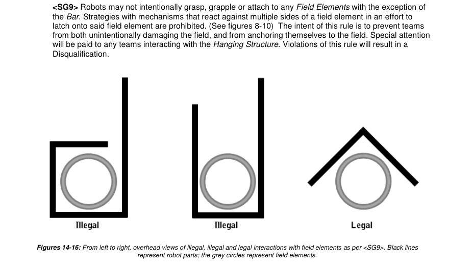

It would be nice if it were more clear as to what constitutes “grasp, grapple, or attach”. An L-shaped piece resting on a field element will react against multiple sides but isn’t grasping, grappling, or attached to it. There was a diagram in the VRC tossup manual that illustrates it well.
I think as long as you are not grabbing or gripping the wall when crossing over I think you will be OK. The wall is only 6" tall and your max starting height is 15". Robots are permitted to expand as much as they want beyond the 15" height after the match starts.
I agree that there is some confusion as to what grasp, grapple, or attach means for this game. Since the rules stated intent in the Game Manual calls out that it is there to prevent damage to the field, or field elements. This prevents a robot from grabbing the ramp to keep from sliding off as many teams did during BankShot. It also prevents teams from grabbing the goals to deposit a hexball.
As far as the Game Elements I think the VRC diagram may be a little more strict than what should be permitted here. I don’t think an L-shaped arm would be an issue for grabbing the hexballs ( Game Elements ) but at no time should any portion of the field ever be latched on, or connected to a robot in any way.
