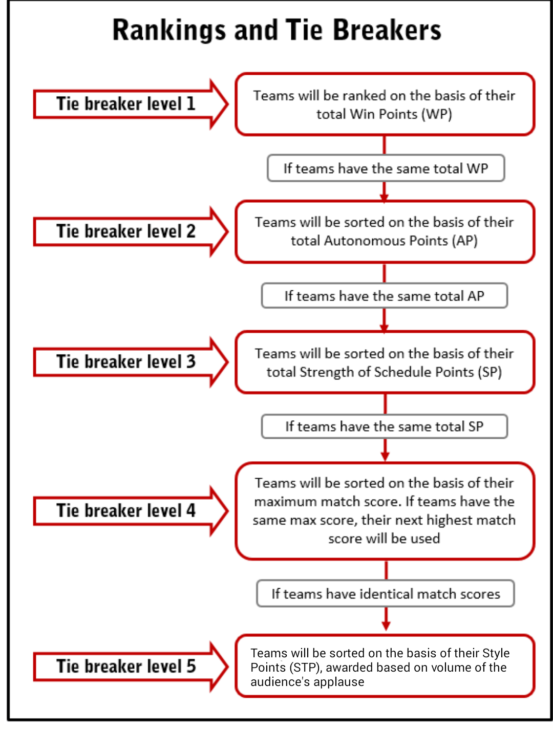

What’s up with the tiebreakers?
Nothing, it was a joke referencing “Style Points” (which aren’t real!). The joke was specifically in tiebreaker level five of the picture I attached :stuck_out_tongue:
So if you get to tiebreaker 5 just launch a cube/star over the fence.
No, If you want style point launch a cube so fast it goes through the middle horizontal opening of the fence and get it in their far zone.
