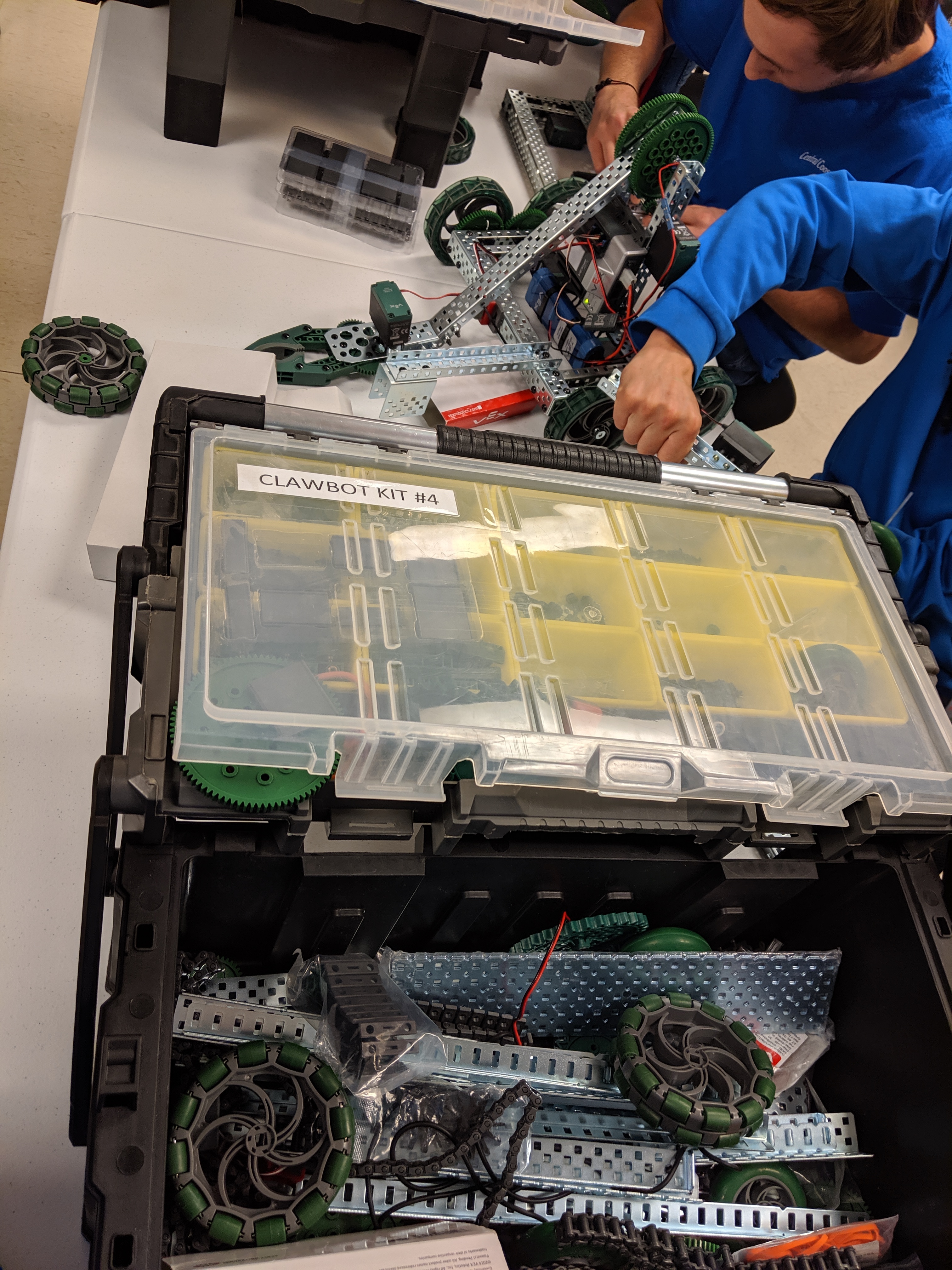

This is a picture of the kit we have that students are building. Basic Claw bot. Can these be programmed after they are built? What platform do we use?

@eleslie, there are actually many coding options for robots now that you purchased V5 Kits. For the legacy electronics (the green motor and the silver cortex), you need RobotC, which is PC only. For the V5 system (the black motors and the brain with the screen), there is VCS (the official coding platform offered by Vex), which is available on Mac and PC, and offers block text for beginning coders. An upgraded version known as VexCode, which is a little bit better in my opinion because you can wirelessly download code. There are also many other options for V5, which is great, but I am not informed enough to give my honest opinion, so feel free to ask others on the forum.
RobotC - Got it, I’ve only got 2 V5 Kits and there’s about 18 students. I’ve got 6 legacy kits… so we will spend most of our time figuring out those and then I’ll figure out how to use the V5 kits with so many students.
