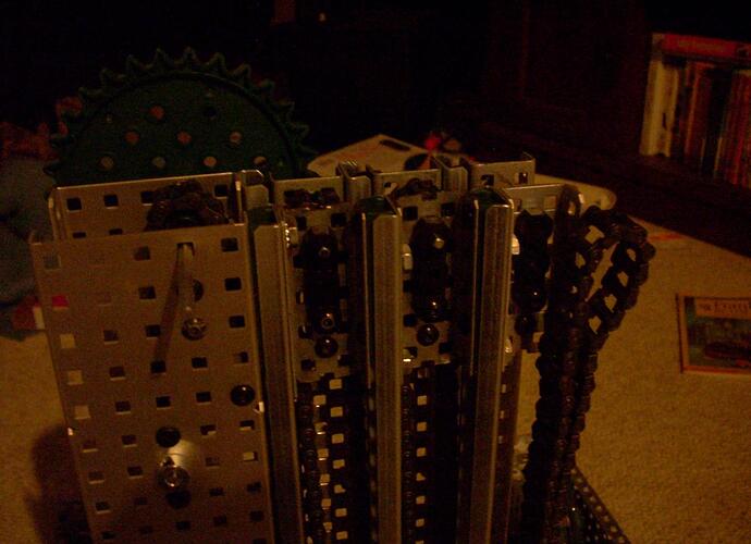

Jpearman, very well done!

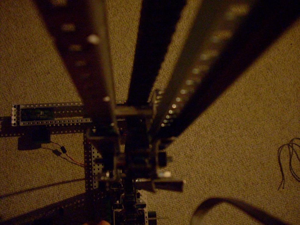

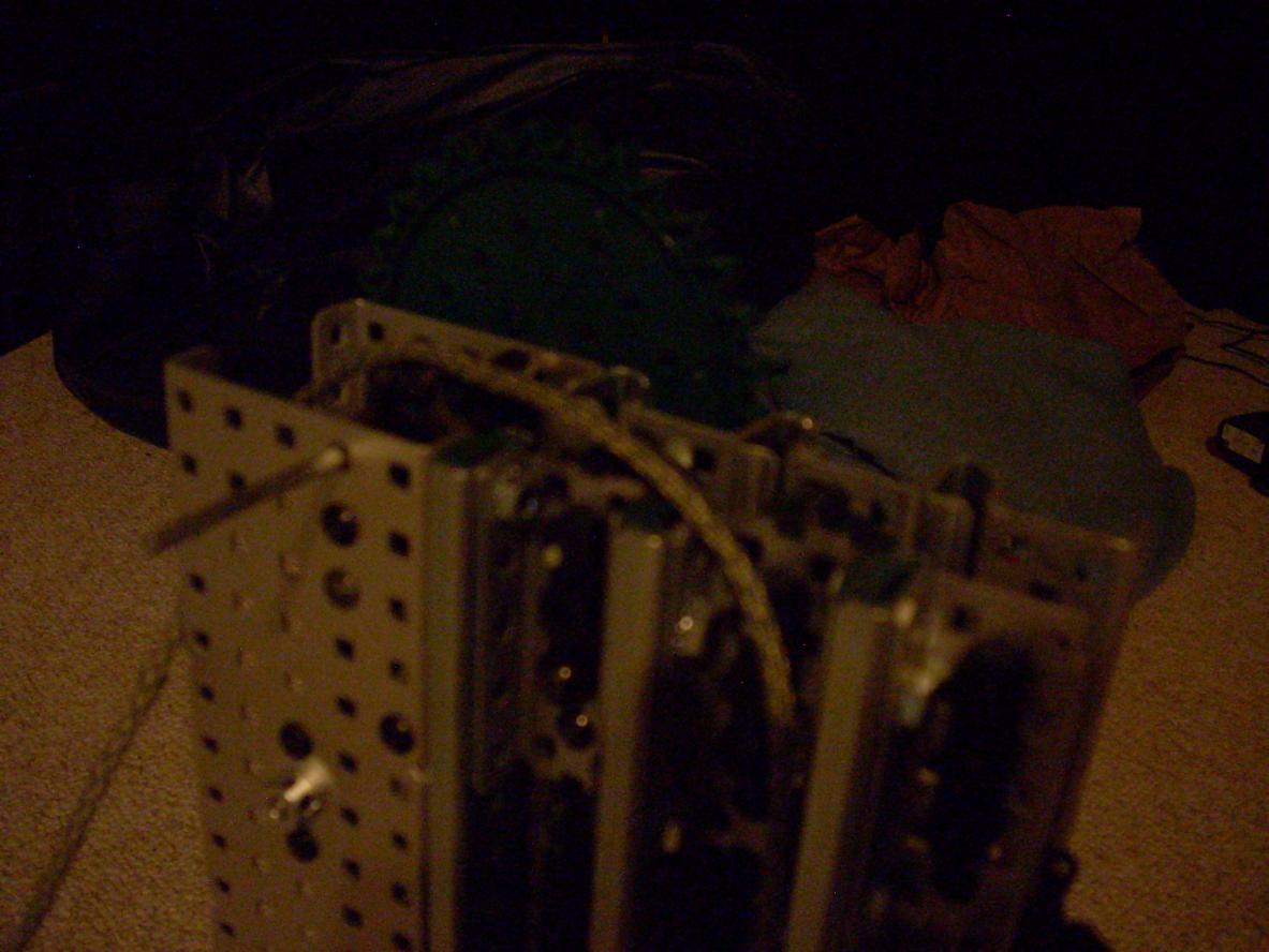

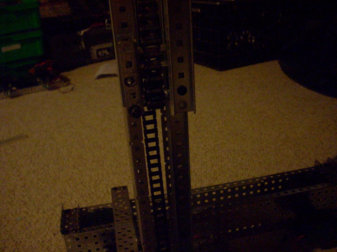

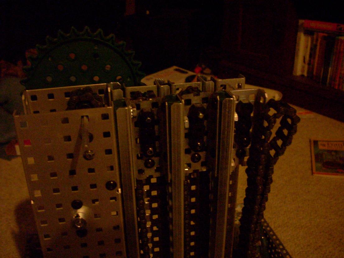

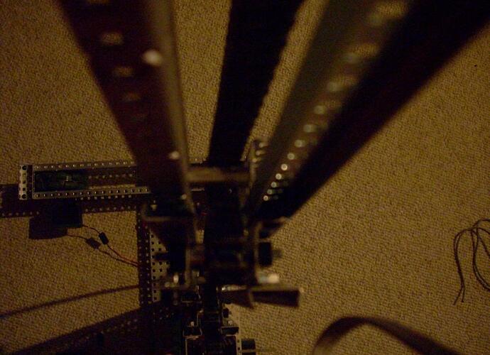

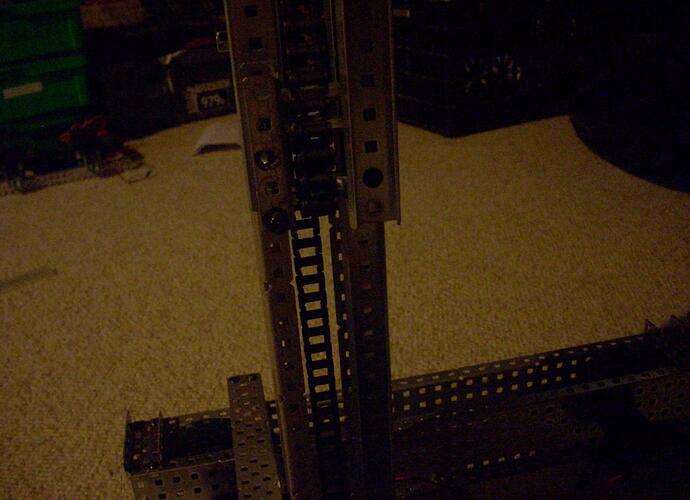

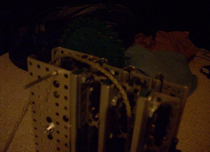

several weeks ago, I prototyped a similar lift, though not as well designed.
https://vexforum.com/attachment.php?attachmentid=8485&stc=1&d=1405820490
https://vexforum.com/attachment.php?attachmentid=8486&stc=1&d=1405820490
https://vexforum.com/attachment.php?attachmentid=8487&stc=1&d=1405820490
https://vexforum.com/attachment.php?attachmentid=8488&stc=1&d=1405820490
Sorry all the pics are dark :frowning:

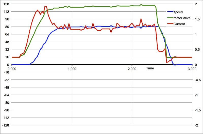

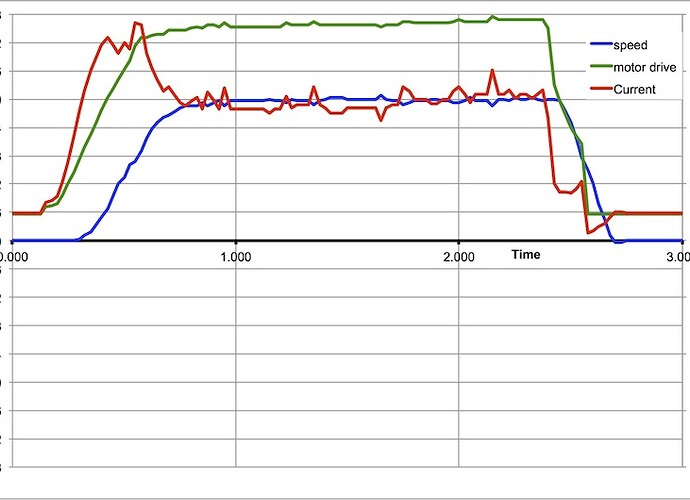

I captured some data for the lift moving full speed between lower and upper limits. The graph shows motor speed, motor drive value and motor current against time. The motor current calculation is pulled from the smartMotor library. This is for the lift going up, manual control was used, joystick was pushed full forwards. Maximum lift speed is limited to 80rpm. The left vertical axis is speed and motor control (either rpm or control value). The right hand vertical axis is current. Horizontal axis is time in seconds.
The motors accelerate (there are two motors on the lift) until they reach 80rpm which is programmed as the maximum speed, the motor control value needed to maintain this speed is a little below the maximum value of 127. Current spikes during acceleration and then settles at about 1.2A, this corresponds quite well with the theoretical value of 1.12A shown in the graph here.
When the lift reaches the full height the motor is sent a holding value of 15 to maintain position, current is about 0.25A with this value and will not trip the internal motor PTC which has a nominal rating of 0.9A (1.8A is trip current, there are lots of forum threads on PTC performance, you need 1.8A for several seconds to trip the PTC )
The time to move the lift is about 2.5 seconds, during this time the encoder changes by 1710 counts (not shown on the graph) which would be 2.73 rotations of the motor (1710/627.2 counts per rev). Each rotation of the motor on a 12 tooth sprocket will move the chain 4.63 inches (vex spec is 54 inches for 140 chain links) so total chain distance moved is 12.64 inches. Due to the way this lift works this means the total lift displacement is 25.28 inches (ie. double the distance). The final encoder error was 4 counts.

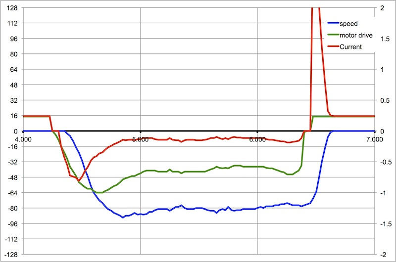

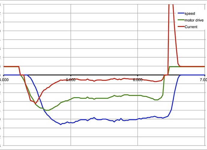

Here is the graph of the lift going down.
Notice that lift speed is also about 80rpm (not quite as stable) but motor drive is much less at about -40. Motor current is very low, about 0.12A, gravity is driving the motor which now acts as a generator and reduces current. As the lift comes to a stop drive is reversed and holding power applied, this creates a brief (100mS) current spike of about 3A as the motor is now braking. The final encoder error was 5 counts.

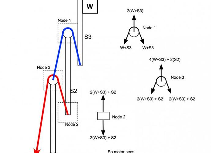

Now I need some help from all the mech-eng students out there.
I retested the lift earlier today with more a substantial game object, a 44oz weight. As expected, lift speed was reduced to about 68rpm, this corresponds to a motor torque of about 4.8 in-lbs from my graph. I have two motors so total motor torque was 9.6 in-lbs. The 12 tooth sprocket I’m using has en effective diameter of 0.75 inches (based on 12 chain links wrapped around it being 4.63 inches). So in theory the motors could pull 9.6/0.75 = 12.8 lb. We can guestimate that there will be losses due to friction etc. and perhaps we have 80% efficiency, this would reduce that number to about 10lb.
So I had a 44oz weight, my third stage weights about 14oz and my second 24 oz. Total weight of all that is 82oz or 5.1lb, way less than the motors were apparently moving.
To understand what was happening I drew a free body diagram, and this is where I need some help. What I have here is more commonly called a cascade elevator, when you simplify the chain connections it would look like this.
S3 means weight of stage 3
S2 means weight of stage 2
W is the weight of the game object
The math here says my motor would see an equivalent weight of (2x44) + (2x14) + 24 = 140oz (or 8.75lb). Still not the theoretical 10lb but much closer.
Adding yet another stage would make this situation even worse.
Thoughts, comments ?

Some more numbers
Lets assume stage 2 is 30 oz, stage 3 is 20 oz and the intake plus game object is 50 oz.
So motors on the lift as designed would need
(2x50) + (2x20) + 30 = 170 in-oz (10.6 in-lb) of torque (which would be about 4 in-lb on each motor with the 12 tooth sprocket and ignoring friction etc.)
If we add another stage the equation becomes (where S4 is weight of stage 4 etc.)
4(W+S4) + 2(S3) + S2
assuming S2 and S3 are the same (both 30oz) we have
(4x50) + (4x20) + (2x30) + 30 = 370 in-oz (23.1 in-lb) or torque, more than double.
We now need at least 4 motors (everything else being equal).
Adding yet another stage would more than double yet again, 8 motors needed or they would have to be geared down and run the lift at half speed.

I’m not ME, but I’ll try to help. :slight_smile:
I re-worked your free body diagram from scratch and came up with the same result. I don’t think there’s any forces being left out. (I say this because that’s what I’m always worried about when I draw a free body diagram… :wink: )
Unfortunately, there are only two major ideas I have where error could creep in:
  1. Is your chain nearly vertical? I can’t tell from the pictures in the OP. If it was angled, I would expect that to increase the overall required force from the motor. (I haven’t worked it out, but I think that the larger force would be proportional to cos(theta) or 1/(cos(theta)), where (theta) is the angle (from vertical) of the chain. This factor is ~1 when (theta) is small, so it shouldn’t make a very large difference, but it’s still something.) We assumed it was vertical in both of our free body diagrams.
  2. If we decrease W to a smaller weight (or take it away entirely), does the lift perform closer to what the free body diagram predicts? If so, it could be that the larger W “bends” the lift more and increases friction in the lift. You said the lift didn’t bend significantly, though, so this probably wouldn’t be the only cause.
These are both “small” things, but perhaps the combination of the two could be significant enough. Sorry this isn’t more help.
//Andrew
What wasn’t on the free body diagram are the slider points.
When you add those in, you also have to account for the torque applied from the center of gravity to the connection point. That is the “leaning” source as you add weight and distance. The older slides had a longer contact surface that could be managed.
A static view of the system gets you the chain’s forces, but adding in the touch points upon sliding, gets you the friction that needs to be overcome before you move for dynamic motion to start. (as evidenced by the nice current mountain required to get that thing moving)
