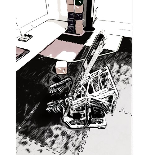

My team has almost finished a new bot, #smallchassisgang, #trayDR4Bgang, however, it doesn’t lift the actual tray, just the intake. This way it makes it much easier to access towers because instead of scoring and descoring from the ground, we can score and descore from above which is more effective. This also allows us to access the center tower. Our robot will be able to hold 10 cubes, cascading tray, and omni wheels. Thoughts?

This certainly isn’t original but it’s an okay approach it has its pros and cons. If it’s built right it can be a pretty good robot design choice. And since you’re leaving your tray on the ground I’d hook it up on a transmission so you can give your DR4B two motors and keep a 4 motor drive, you’ll need it with a heavy lift.
first of all I would need a picture to really know if its going to be good or not. S
Overall i would say it isn’t good. With a goofy(complex tray) bot you can easily score and descore towers. You can also put cubes in the top tower with a tray bot(even a linear/telescopic(cascading?) slide tray bot). The only advantage would be descoring the top tower, which really isn’t worth it when you have to design your whole bot around that one purpose.
Tldr: tby not worth it man your robot will be worse. I understand if you have problems with a goofy(complex) traybot. But you can easily fix those to make your bot good

This is a robot just like goofy, only difference is that it has a DR4B not a 2 bar

I’d have to disagree with everyone saying that building this is a waste of time. The disadvantages of this design are not unheard of in the meta and it does have an opportunity to be goofy+1 with the easier high tower placement.
I really dislike this ‘meta or lose’ attitude. I know many think that the meta is somehow superior to all other ideas by default but you are only discouraging new designs.

This is our design, worked well for us since beginning of the competitions. Srry, don’t want to leek yet (created with apple clips). image
That a cool idea of sharing a design without sharing too much, it looks good.
drivetrain looks the same as mine. Good looking bot. Looks like what we are going for
