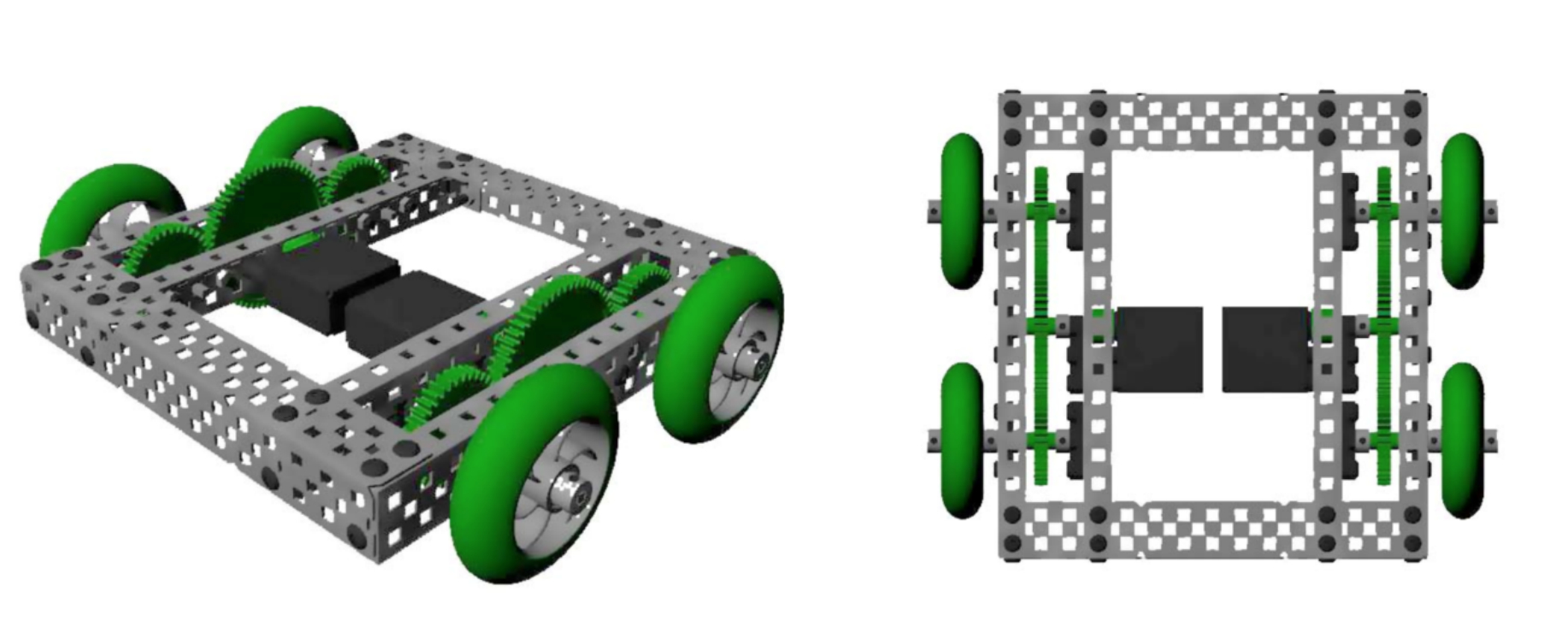

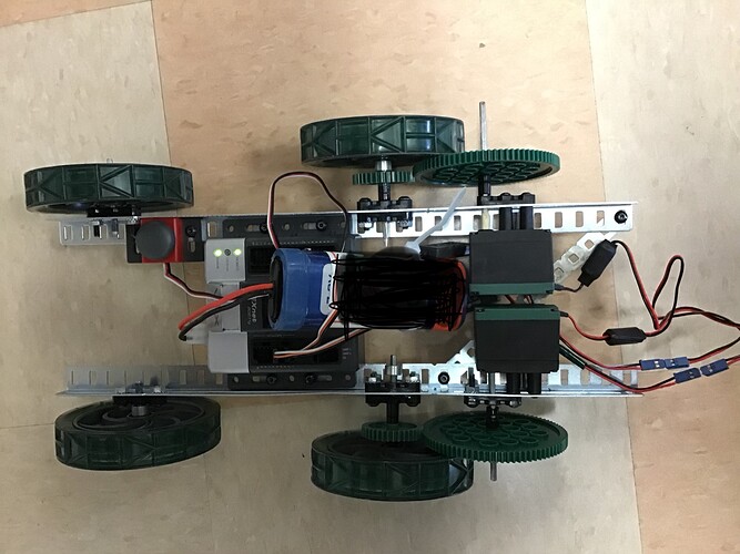

For some reason, we are now facing the problem of it going slanted. FYI: Since we don’t have enough shaft collars, our teacher told us to use tape.
#11
Wow that’s bad.
Those rails are really old VEX parts and kind of suck. Furthermore you should really have the shafts going through two structural points on either side of the wheel or two on one side. Look at the chassis kits.
10%20AM
#12
This is the best answer. Those rails are awful, and you need two points of support on every axle ALWAYS. Plus, you don’t have to worry about so many collars if you just use one and then have the axle go through two chassis bars.

@AperatureLabs @anon35188833 Thank you very much. We will take this into account. Are there any other general building tips that we can use?
#15
Dont cantilever your axles and try to only have plastic on plastic. Also make sure that you dont have motor side bearings unless it is a very high stress joint.
#16
What does cantilever mean?
#17
have your shaft going through 2 points of support rather than just one. basically I advise following the images @anon35188833 posted as closely as possible.
