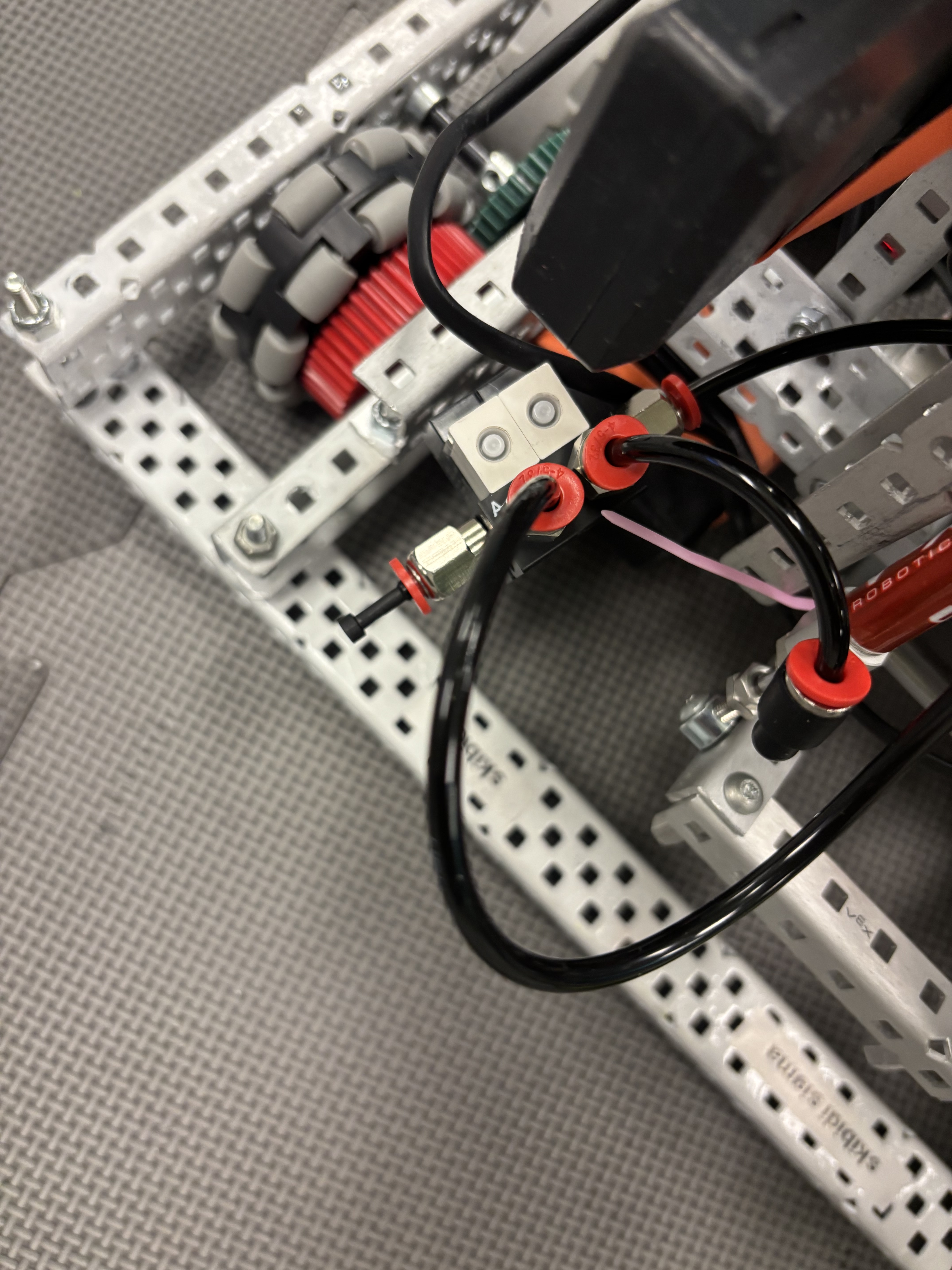

Air is able to flow through the rest of our pneumatics tubing perfectly fine but as soon as it gets to the front two holes on the solenoids, air doesn’t come out . We tried taking off the entire fitting and air still just wasn’t coming out. We know that air is able to make it in the solenoid because when we took off the tubing attached to it, all the air was able to come out. Is there any way to fix this?

Is your solenoid plugged into the brain? I can’t see a wire in the picture. The whole point of solenoids is to block air until an electrical signal gets sent through them, so if you never send that signal they won’t let air through.

Make sure the solenoids is plugged into the 3 wire port all the way in. If that doesn’t work, you can determine it’s a solenoid issue by not hearing a little tick by pressing the button. If it’s a button issue, make sure it’s coded correctly
As @Entropy said, a picture or series of pictures showing the whole setup would help.
Off of this picture though, it looks like you forgot to plug the solenoid into the brain.

Are the wires on the solenoid done correctly?
