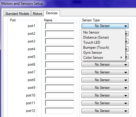

No Analog Tab
I just downloaded the newest version of RobotC (4.52). When I tried to set up my quad encoders in the motor and sensor setup window there was no analog tab. I looked in the devices tab but the drop down windows only contained digital sensors ( see attached file). Is there something wrong with my version, am i doing something wrong, or is the new update bad.
Help please
P.S I am a Vex EDR user
just before you answered i figured that out for my self but thanks
Looks like you have the VexIQ platform selected. Switch the platform type to “Vex 2.0 cortex” (robot->platform type menu).
