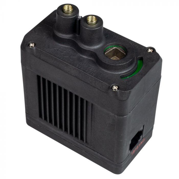

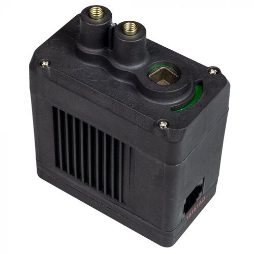

V5 motors look like this:
They were announced in 2017 and released in 2018 for Turning point (that season’s game).

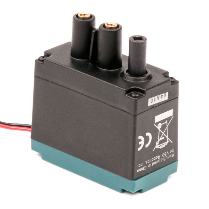

V4 motors look like this:
They have been around for ages (practically since the 1st few VRC games).

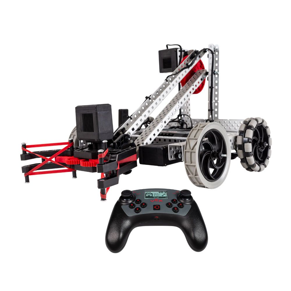

Easier to identify clawbots:
VEX V4 Cortex ClawBot:
V5 ClawBot:

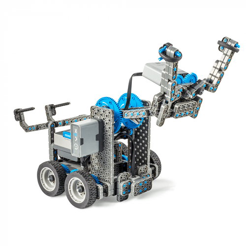

VEX IQ ClawBot:
For all of these to look for courseware go to education.vex.com
V5 STEM labs you will find support for V5 and a link to Legacy curriculum for V4 Cortex:
https://education.vex.com/stemlabs/v5
If you have V4 or V5 in HS, I would take the V5 certification and adapt as needed.
