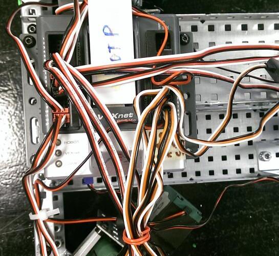

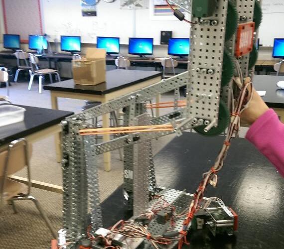

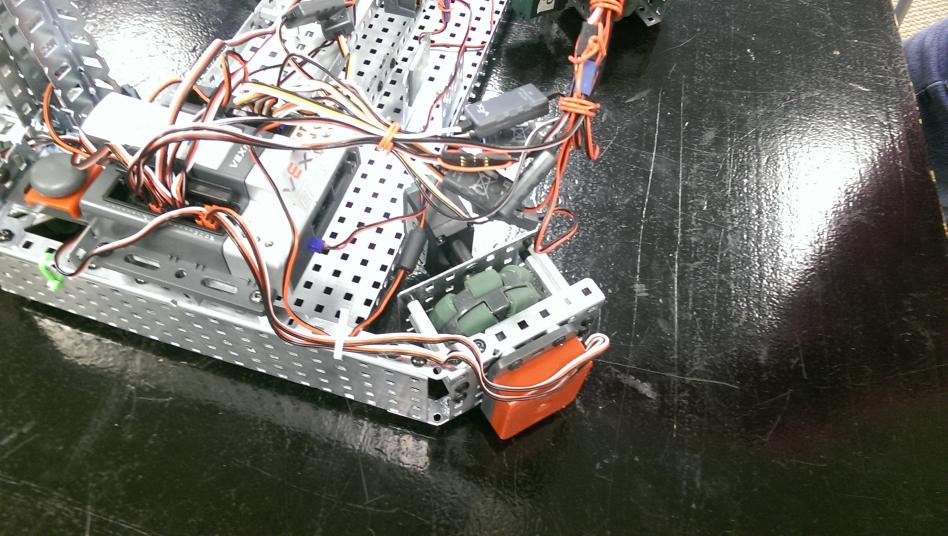

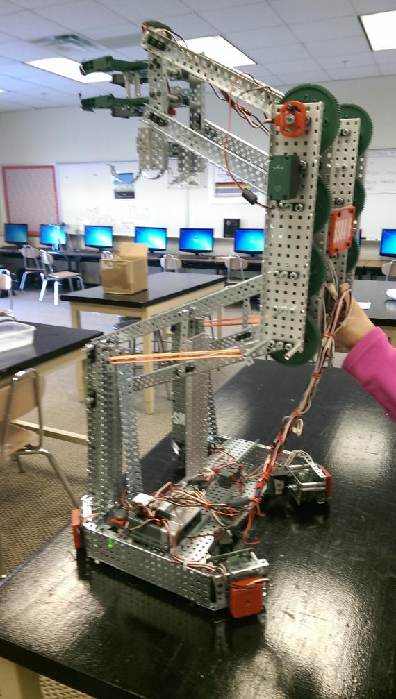

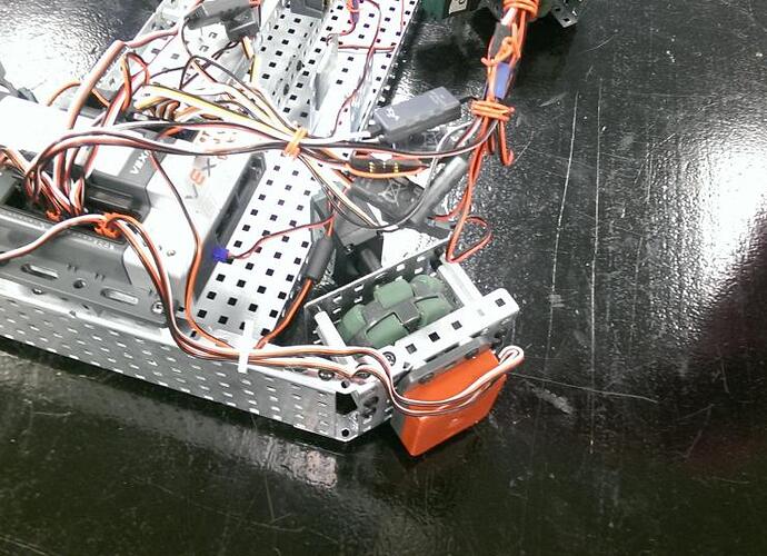

No ptoblem, here are some pics.
Each wheel is driven by one motor, direct driven. No axles are bent. The encoders are not causing any problems. We are still puzzled.
Motor ports
1: LF drive motor (hi speed)
2: RF drive motor (hi speed)
3: LT lift motor
4: LB lift motor
5: RT lift motor
6: RB lift motor
7: empty
8: Claw motor
9: RR drive motor (hi speed)
10: LR drive motor (hi speed)
All motors are 393s. The lifts and claw have standard 100 rpm hi torque gears.

Sorry if I’m being picky, but I just have to correct you.
Your robot’s drivetrain is a x-drive not a H drive.
The 2.75" wheels on x drives and heavy robots do not work out to well. They don’t roll well to begin with because they are such a small diameter and the rollers are the same size as 4" omnis, and when you put them on mat where they sink in and on a heavy robot it puts a lot more strain on the motors than an x drive with 4" or 3.25" would’ve.
