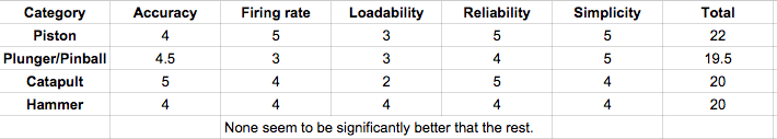

I’d like to discuss the 4 types of non wheel-based launchers that can be used to score balls this year.
If you can think of any more categories, please explain what you’re thinking of.
—The Piston launcher:
The piston launcher utilizes a linear pullback and release connected a piece on C channel.
This piece of channel collides with a stationary ball at high speed to propel it forward.

—The pinball/plunger mechanism:
The pinball/plunger launcher is similar to the piston launcher in that it uses a linear pullback and release, but the ball is constantly at the end of the plunger.

I think that this would be harder and slower to load, but it would have better accuracy because of how it isn’t whacking the balls, but in stead, the ball are going up to speed with the piston.
—The catapult:
The catapult has a fast moving arm that has a spot for the balls to sit. When the arm comes to a stop, the ball(s) continue through the air just like a classic medieval catapult.

—The hammer:
The hammer is an arm that swings up and hits a stationary ball on a platform to propel it through the air.

Here are scores that I give the launchers out of 5 relative to each other and against flywheels, and based on what I’ve seen in videos and at competitions.
If you disagree, please explain why, and maybe make your own chart. (The chart is and attached file)
I’m trying to decide which one is generally best, but I haven’t found anything that proves that one is superior to the rest.
I have minimal experience with building any of these, so I’d like some feedback.
Thanks.

Based on the videos it looks like that slip gear “hammer style” launcher looks like it has the highest fire rate and best accuracy. One of the benefits of having that high of a fire rate is that you can take away a few motors and just gear it more for torque since you will never be firing quite this fast.
Obviously all of these designs work well, which is why they’re on this list. If I were to choose a design from these four, I would probably pick the hammer design for the same reasons that Michael just said.
I’m not sure why you gave the hammer a 4/5 in accuracy. In the video you posted the hammer design had 97% accuracy.
I gave the hammer a lower rating because this is the only one I’ve seen with good accuracy. So I know that they can have great accuracy, but they generally don’t.
