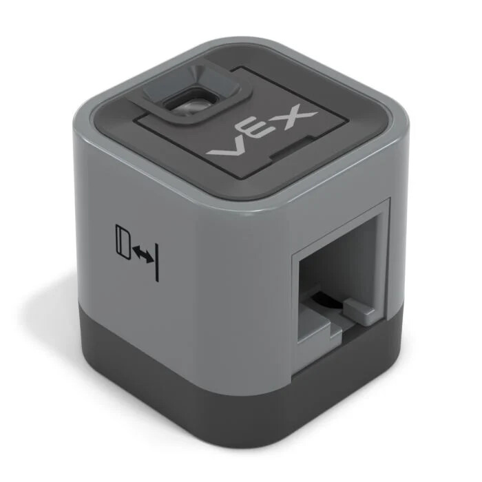

You have the IQ distance sensor, it looks like this.
When going to the devices screen you can see the sensor, but the numbers do not change ? Do you see a screen like this ? If the numbers do not change then what happens, does it show dashes “—” ?
