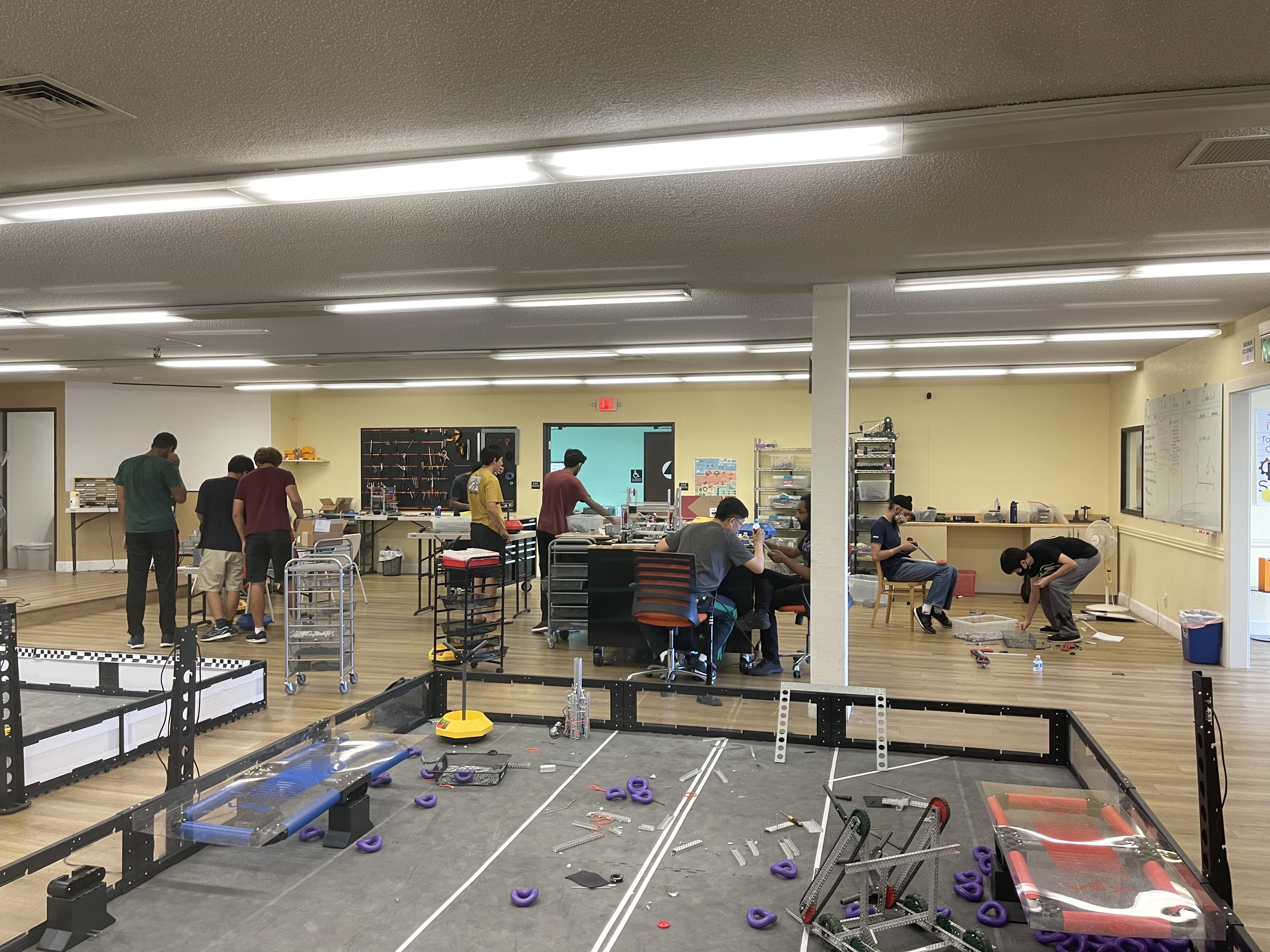

We proudly present our RI3D for Vex Tipping Point!
Massive thanks to Dublin Robotics Club for hosting this RI3D from July 2 to July 5!

RI3D - Working Sessions. July 2, 3, 4 and 5 at Dublin Robotics Club, non-stop, 72 hrs. Lot of hard work by NorCal VEX Alumni. Great Job :+1:. Kudos to them :clap::clap::clap:
