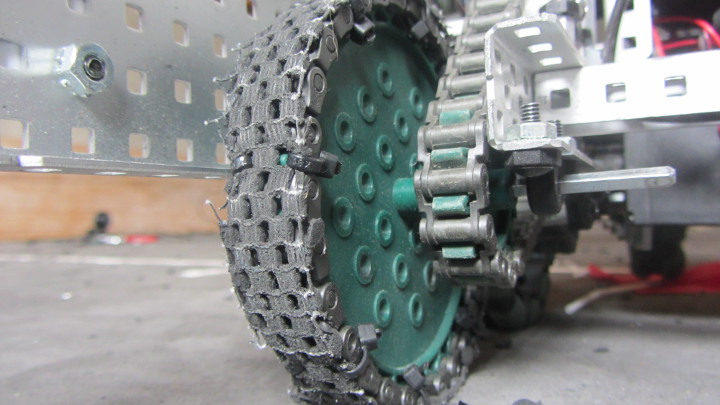

I have a question about the super-traction wheels.
We were just watching your robot drive around during Robot Skills, and you seem to be turning just fine. Really well, even. Can you give us an idea of how they compare to the use of four Omni Wheels?
We’re using strictly Omni-Wheels for mobility on our robot, but we’re always looking for ways to get a bit more pushing ability. But is there a reduction in speed or turning ability?
During driver skills we actually switch to all omni’s because they’re a bit more mobile. The Traction wheels don’t reduce forward/back speed whatsoever but the turning speed is reduced a bit. In reality the difference is pretty minimal, but it really depends on your robot and how you want to play the game.
An interesting high traction wheel design!
How about sack jam issues?
None at all. The traction wheels have never gotten stuck, practice or match, on sacks. Any problems in terms of getting stuck has been on the small omni’s in the front, which even that is pretty rare.

Greetings, and congratulations on your victory. I’m curious, how do you deploy the flip out wheels in the back? How exactly do they work?
Thanks! They are carefully tuned so that when they are pushed back, even the slightest vibration is enough for the wheels to push out and deploy. I tend to use the white spacers in the back as some upwards friction to help them stay in place as well.
Brilliant idea! We were going to use pneumatics but this concept could save some time and money!
Yup, and it takes no time to build too!
