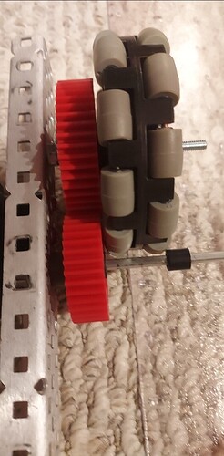

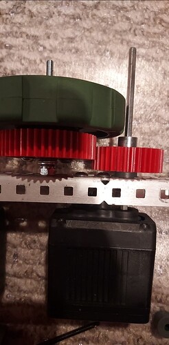

I’ve been working on a 36:48 3.25" drive train and I realized there isn’t enough room for a thin spacer, let alone a shaft collar to hold it on. Does anyone know an easy fix so the 36T gears can’t slide around?
You should use a thin 36T gear, that way you have enough space for both
Would that work for competition though? Just concerned a thin gear could break mid match

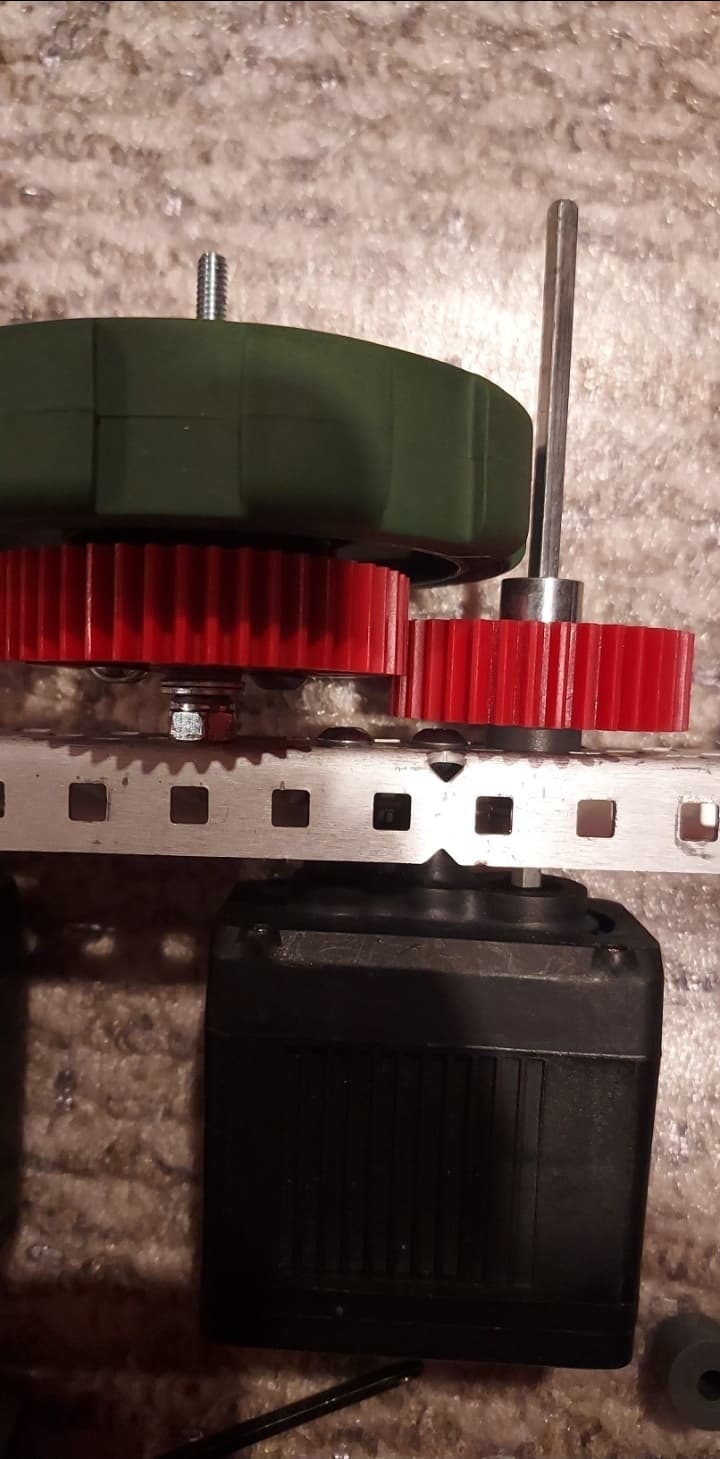

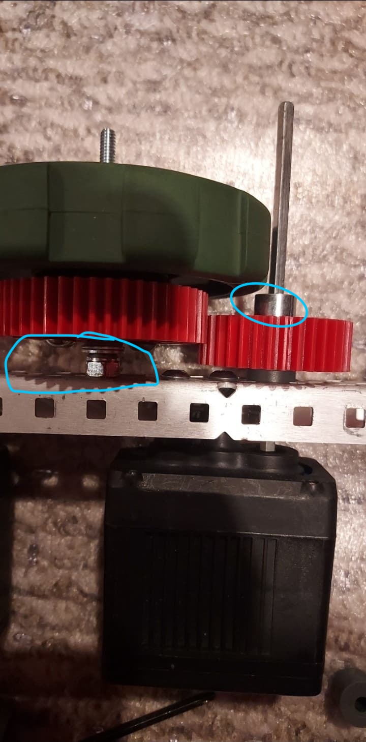

Thank you! I was also thinking would something like this work? Basically the same as using a small gear spacing wise but won’t have to worry about breaking (even if it probably won’t)
I am not a big fan of cantilevered shafts off of motors, you may get skipping…
But, if you go down this route,
  1. move shaft collar to other side of c-channel near motor and use a capped shaft… you can use manufactured one from vex, or hammer down one end of shaft so it can not go through gear to hold gear in place.
  2. use thin nylon you can save a little more space. Screw joints are nice until they are not.
yes that would also work but when you use omni wheels because they are slightly bigger it might hit the shaft collar. But you could always add more spacing for the wheel.
Sorry for any confusion, from what I can gather cantilever means it’s only supported at one end yes? I’ve been working on fixing this issue first, there will be another c-channel on the outside with bearing flats on one side and shaft collars on either side to help support the shafts. Thank you for the tips though!
Awesome thanks! The omni wheels aren’t hitting the shaft collar so assuming this doesn’t cause skipping or anything it should be good to go.
Correct, some people do just shove a shaft into motor only in one side and expect no issues to arise.
You can also attach screw joint on opposite side of chassis and have bearing flat, in this way the two gears will line up better.

Ooh thank you for the suggestion. In that case, I might add a bearing flat on the other side and adjust the screw to line up.
