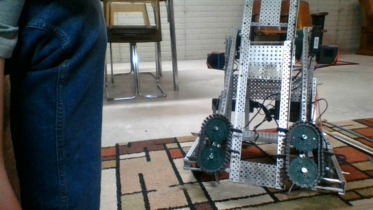

Nothing is working and i have a competition at 8:00am tomorrow!
I am basically a one man team because my teammates do NOTHING!!!. I can’t get cubes up the tray because they angle is too high OR I need more compression on the intakes… I am running very very low on resources to use. How can I make the cubes intake with ease but also stack without causing the intakes to block the tray. I NEED HELP AND I AM OUT OF CHOICES!!!

that looks like a steep angle… The ideal tilter angle is as close to 45 degrees as you can get it. (additionally it looks as if the try will contact the ground when it is tilted upwards)
Looks like you could use some more flaps on your intake. Also do your arms twist out when intaking? If so are your c-channels boxed?
I have no flaps. Are do go out and the arms are boxed
if you’re really pushed for time, and if you aren’t likely to get the tray and intakes working, I’d say just screw it and go 8m pushbot cause why not. but don’t do that unless you’re out of options.
It’s too late at this point. Not trying to be pessimistic or turn you down, but at this point, your odds are better if you clap a quick wall on that traybot, and give it a 4 motor drivetrain. There’s not much more time to rig up anything sophisticated.

As a suggestion for future comps, move ur arms in towards the tray try increase compression.

How many cubes can it hold right now?
Maybe I’m missing something but why is 45 degress the best angle? For me the lower the tray is the more i can stack because less angle puts less force against the rollers.
Your tray sticks across the field and it whacks stuff

but since butternubs has a pretty short tray a low angle is prob fine. being able to stack is more important than wacking things.
Hey, man, I feel your pain. But I know you can do it! You are probably going to the same competition as I am and need that finished by tomorrow morning. Just tonight I programmed all of my code so that it would work after not working pretty much at all and also redesigned my whole block stacking system so that it would be ready for tomorrow. I don’t even have autonomous finished but i believe that it can be done. Just have confidence in yourself and take charge and get it done. I believe in you! There is so much that one person can do in a day that it is UNBELIEVABLE. I would not wait for answers on this forum. I would just get the robot complete or near complete for this competition. by the looks of your robot, you are going in the right direction you just need to make a few upgrades. I would say to make your slope more horizontal as that would allow for a smoother block intake. that should not be too hard as all you have to do is move the base of the block holder forward. This will also serve as a shortener for getting inside 18 inches. The intakes moving in will take a little bit more effort as you will need to unscrew the gears and possibly flip them so that they are facing inward. but this could cause problems with the tray. another way to do it is to take off your high-strength spacers and move the gears inward to decrease space between the two intake rollers. I advise you go with my first suggestion and then if that does not get you to your goal then try the other one with it.
EDIT: I would also add more of the flaps to your intake rollers in order to increase traction between the block and your intake rollers. this will help to push the blocks up more
Yes I would agree more compression should be added to the intake and more flaps, that’s the least flaps I’ve seen on any robot, that should be an easy fix. It will signicsntly increase the perfomsnce of your robot.
