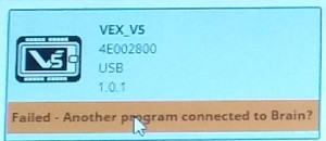

I tried to update the brain but it said a program was already in use. Kept prompting me to update. I tried a few more times. The screen began blinking and now it won’t turn on. Even the battery won’t turn on.

Where/what exactly said a program was already in use ?
Try the stand alone updater available here (make sure VCS and any other programs that may try and communicate with the brain are closed)
VCS said a program was already in use. I’m on a Mac.

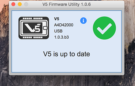

The Mac firmware utility won’t download. This is the first option I asked about. The standalone VexOS updater. The second set of options are for PC only.
yes, that one, the other utility is for the cortex.
What version of OSX are you running ? vexos 1.0.0 was not compatible with Mojave so you can’t update using that.
So you can’t even download the V5 firmware update utility from the above link ?
Can you post a screen shot of the error message
Do you ever see connection to the V5 like this ?
I got it to download and update. Thanks a ton. I do have Mojave. Of course that would be the case. #sarcasm. Thanks again.
