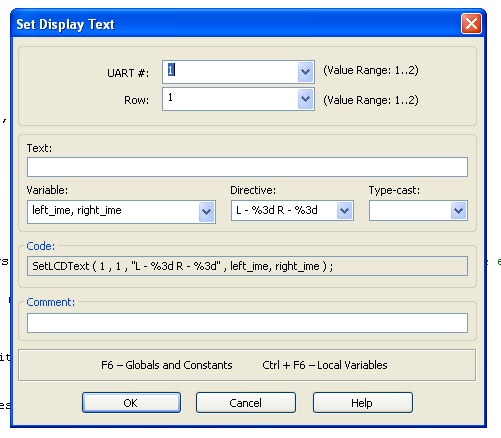

One other item that constantly irritated me when I was working with easyC is the ability to display only up to one variable at a time on the LCD. (This may not apply to the text editor; I’ve never tried that function in there.) My LCD.h code displays 3 (again, by drawing characters on screen at location X).

You just add them in the Set Display Text window. For example, two variables.
[ATTACH]6517[/ATTACH]
