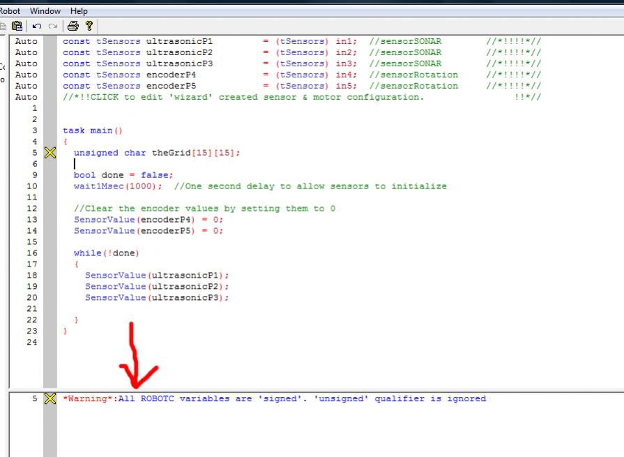

I am writting a mapping program for my vex, however robotC does not let me have anything larger than a 15 x 15 array of anything. I figured this was due to memory issues. So I tried using an unsigned data type but that of course isn’t allowed. Why is this? All I need is a decent sized 2d array of single bit data. If theres enough memory for a 15x15 grid with 8bit data then surely a 50 x 50 1 bit data grid is feasable. Is there a way around either of these restrictions?

This was what I was planning on doing. However the ROBOTC doesn’t allow any kind of “unsigned” data types. So, how can I make it so I can access the individual bits.
@esklar81: Thats very clever, however it still leaves the problem of "How do I get access to the bits when I cant have unsigned data types? It would seem there is another way, would someone mind explaining?

I assume you are meaning to bitwise “and” the numbers and “word”. If that is the case then yes this is allowed. Thus with this (rather large) hint my mind is beginning to formulate a hypothesis for an algorithm to make this work. Looks as if the “splitting” part will take the most creativity here.

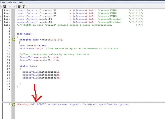

Just so you can see what I mean by “usigned types aren’t allowed”, I’ve attached an image of the warning.
