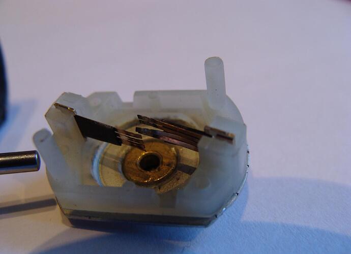

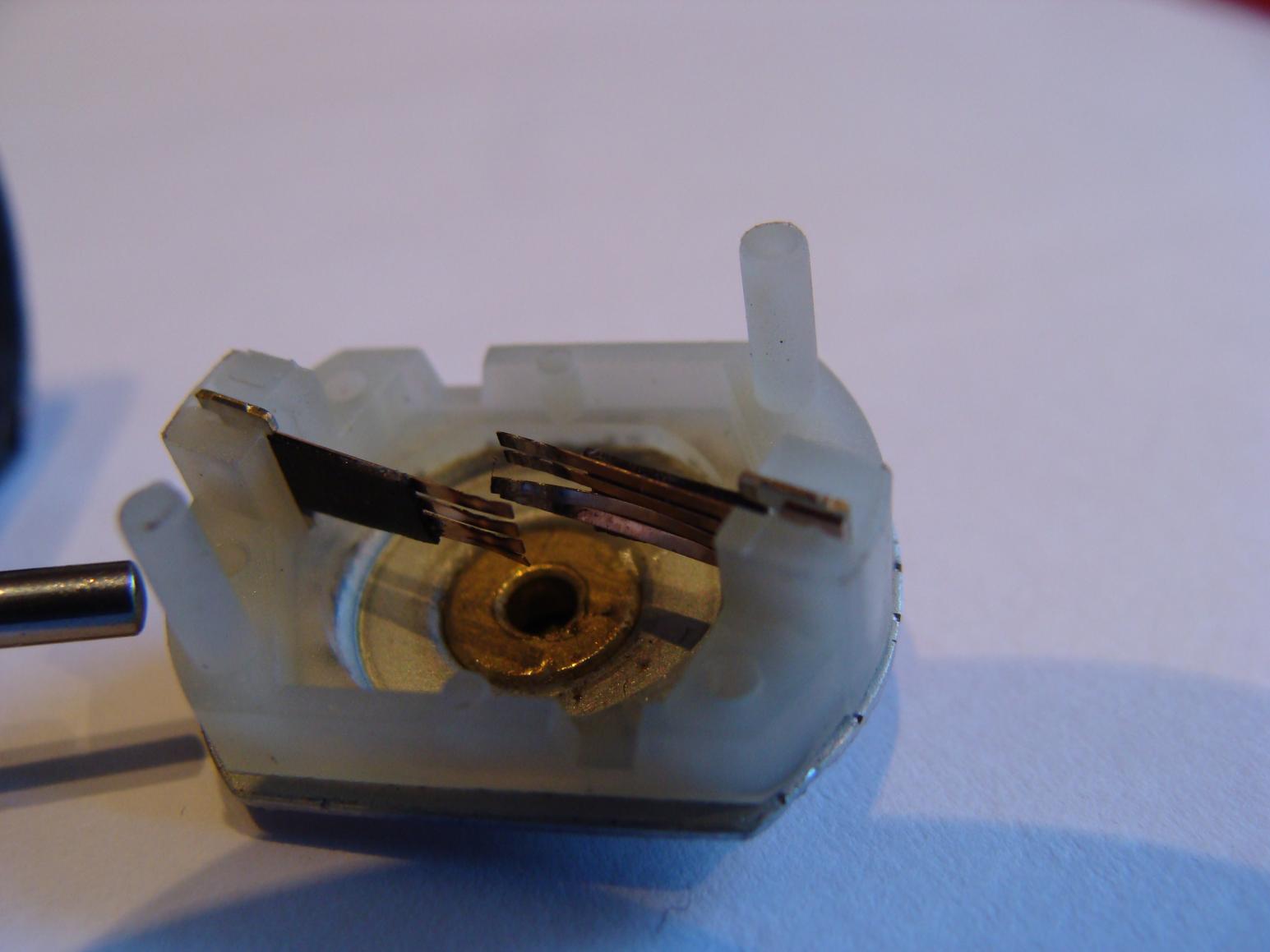

I think that you will find that the brushes are damaged within the motor, I posted a photo of this some time ago as we have had a similar problem.
Rob
Yeah, do you know why the brushes get damaged? Is it just having it stressed for long periods at a time? Or does it just happen naturally to every motor over time?
From what I have observed, the brushes on one side of the commutator may (there are two sets) get temporarily spot welded to the commutator during a motor stall event. Once the motor breaks free the brushes bend on one side only, or the brushes simply get caught in one of the three gaps in the commutator causing them to bend.

Has anyone ever opened up a dead motor to confirm that momentary spot-welding, or bent brushes in general, is the reason for our dying motors?
It makes sense, but still…
I’d love to see it if anyone’s willing to go through the hassle!
yes i have pulled appart some of these motors and here is a link to the photos.(I hope)
Thanks! Interesting how that works. I suppose we just push these motors too hard.
